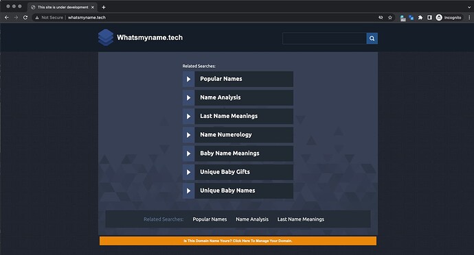

Using Chrome however I see this, which is certainly not the same result as above.
cURL explains this behaviour
$ dig whatsmyname.tech A +noall +answer
whatsmyname.tech.	1538	IN	A	66.96.162.142
whatsmyname.tech.	1538	IN	A	75.2.60.5
There domain uses NS1 nameservers with has multiple A records. One shows the very simple HTML from Netlify, the other a page with an <iframe> that loads another (possible dodgy) placeholder site.

Thank you for checking it out! Not gonna lie, don’t completely understand how this works like why when curling it loads the Netlify hosted HTML, and when navigating in the browser something else. Just a server config? My ISP blocks the first one as well actually. For the time being, I’ve reported a false positive to Avast hopefully they can resolve it quickly otherwise we’d have to just move to a different IP.
If you can load the Netlify version, this is what you would see:
This I was able to achieve by using Opera’s built-in VPN set to Americas. Using other locations render a “this site is blocked” message.
So the content served is based on the location it is requested from.
