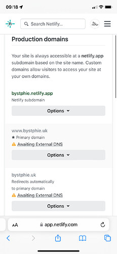

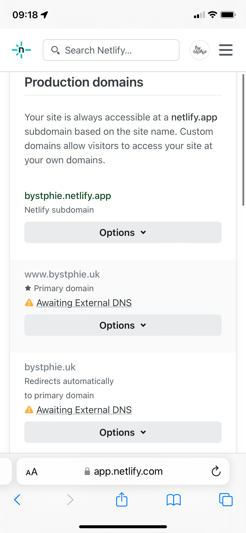

My domain was working well with Netlify, had it set for bystphie.uk to take you to the main page and design.bystphie.uk takes you to bystphie.uk/ design. I want to introduce shop.bystphie.uk which takes you to my shopify page, hosted by shopify. This works fine however now the Netlify part of my site doesn’t work. It says Netlify is awaiting me to set the name servers from my external provider but I didn’t change this and my external provider has had the netlify name servers all this time. All that I did in regards to shopify was connect the subdomain shop.bystphie.uk and add the a name and c name to the dns settings for the domain on Netlify. Any ideas? Thanks
Can you provide a screenshot of the Netlify DNS records and custom domain settings for the site @bystphie?
The reason the domains are showing Awaiting External DNS is because you have deleted the the NETLIFY records leaving only the NETLIFYv6 records.
For more information on what these are read [Support Guide] What are the NETLIFY and NETLIFYv6 type DNS records? How do I delete these records?
You have two options:
  1. remove bystphie.uk and www.bystphie.uk as the production domain, then reassign it. This will recreate the missing records.
  2. Wait for a member of Netlify’s support team to recreate the missing records for you.
Also note the record for design.bystphie.uk will not work as bystphie.uk/design is not a valid value for a CNAME record.
Also note, you should only have an A or CNAME record for shop.bystphie.uk, not both.
