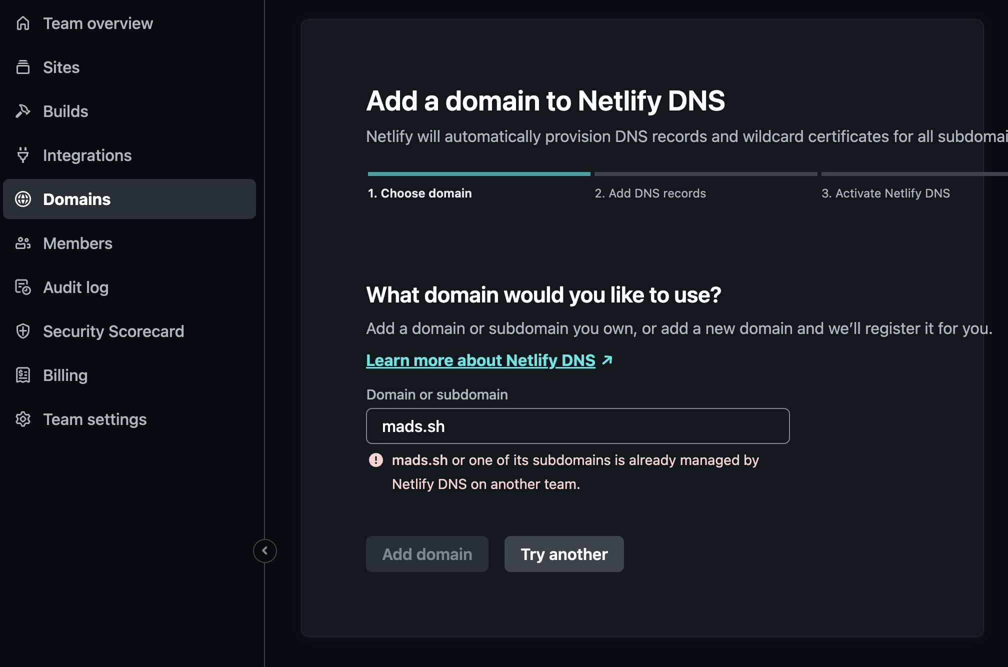

Issue:
mads.sh or one of the subdomains is already managed by Netlify DNS on another team.
Specs
Netlify App : https://madssh.netlify.app/
Domain Name : https://mads.sh - Formerly managed by DigitalOcean but trying Netlify to give a try, seems like when I purchased this in 2022 it was previously deployed here or managed?
Is it possible to get help to delete the old setup? Can’t remember using it on any work-account on Netlify or any other account (that i probably don’t have access to).
I’'ve added the TXT record as suggested here for verification.
Site ID : b9683b4e-adb5-4e5d-bf6f-20f8607464e5

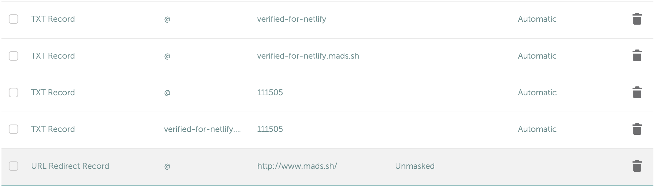

So do I write the hostname to verified-for-netlify and the value as mads.sh ?
I now have these TXT Records:
Host
Value
111505
111505
verified-for-netlify.mads.sh
dig
February 1, 2024, 8:40pm
12
For most registrars, when entering the record name there is no need to append the domain.
The first three TXT records in your screenshot at the domain apex (this is what at @ indicates)
$ dig mads.sh TXT
mads.sh. 2250 IN TXT "111505"
mads.sh. 2250 IN TXT "verified-for-netlify"
mads.sh. 2250 IN TXT "verified-for-netlify.mads.sh"
The fourth is the record I previously mentioned where you have set the name as `verified-for-netlify.mads.sh.
With any of these records if you changed the current name to verified-for-netlify (only) it would show up as verified-for-netlify.mads.sh
Check out this Namecheap knowledge article for more on adding records
