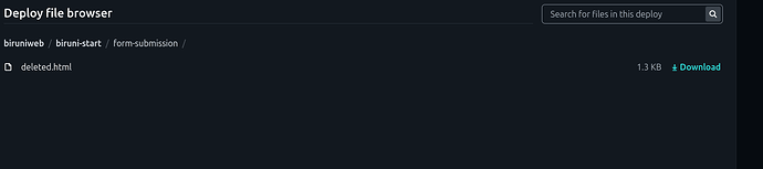

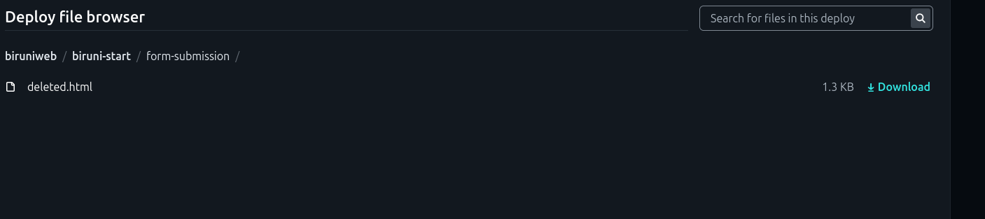

Check what files exist in your deployment with the Deploy File Browser .
G_G
July 2, 2025, 1:58pm
7
This is what I have inside of it:
It seems to be a real page.

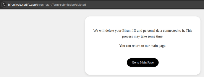

@G_G That’s a completely different URL.
That’s not:
/form-submissions/deleted
It is:
/biruni-start/form-submission/deleted
Which loads here:
https://biruniweb.netlify.app/biruni-start/form-submission/deleted
