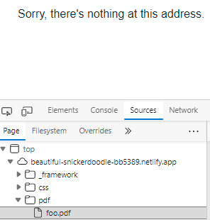

The folder wwwroot that I drag and drop to deploy contains the file /pdf/foo.pdf. I want this pdf to be displayed in a new tab with <a href="pdf/foo.pdf" target="_blank">Open pdf</a>
but my Blazor app tells me
Sorry, there’s nothing at this address.
On this “Sorry”-page the Dev Tools > Sources > Page display the file foo.pdf but when I download it from there, there is no text in the file, where should be “test pdf”.

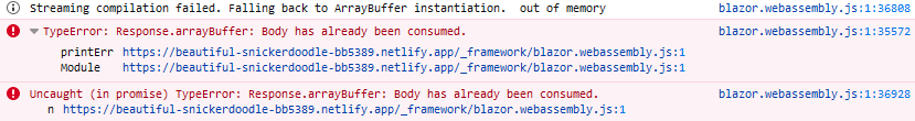

I also tested different browsers. Chrome and Edge only show the “Sorry”-page but no message in the console.
Firefox does not show the “Sorry”-page but the following message in the console:

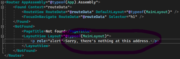

The error is not a browser 404, it is a message from within your app (as evident by looking at the page source—see below), which indicates your app is handling the request (at least in some instances.)
Sorry, I did not mention this. I know, it is not a browser message but from within the app:

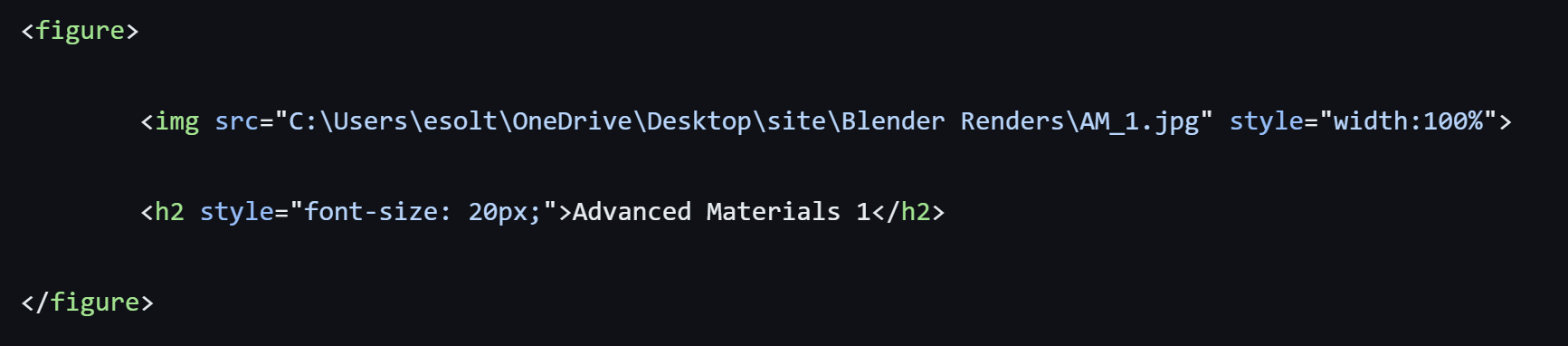

Hi, I have a similar question. I created a site with Netlify, but the files linked to in my index.html are not showing up for some reason. I used the drag and drop method with the folder called “site”, where I have stored my index.html which has all the code needed for the site and another folder called “blender renders” which just has a bunch of the media files in it. I also attached an example of the way that I am linking to the files from my index.html code.
Should I do something differently whether in the Netlify deploying process or just my code itself, to get the files to show up on the https website?
