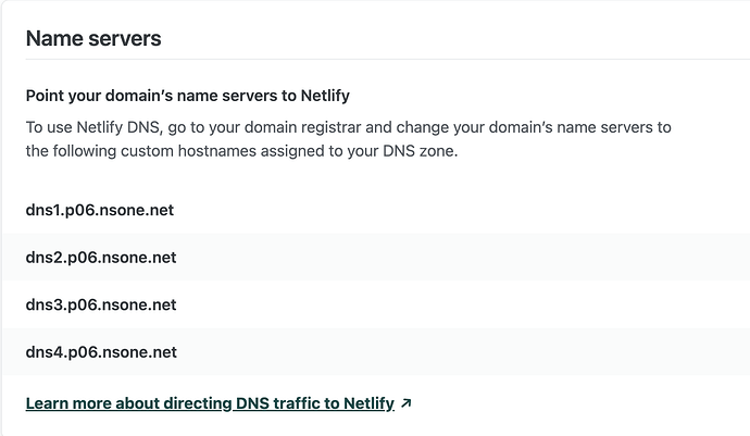

Since this is a new account, I can only include a single screenshot.
So here are the other ones:
Required nameservers:
Configuration in Namecheap.com:

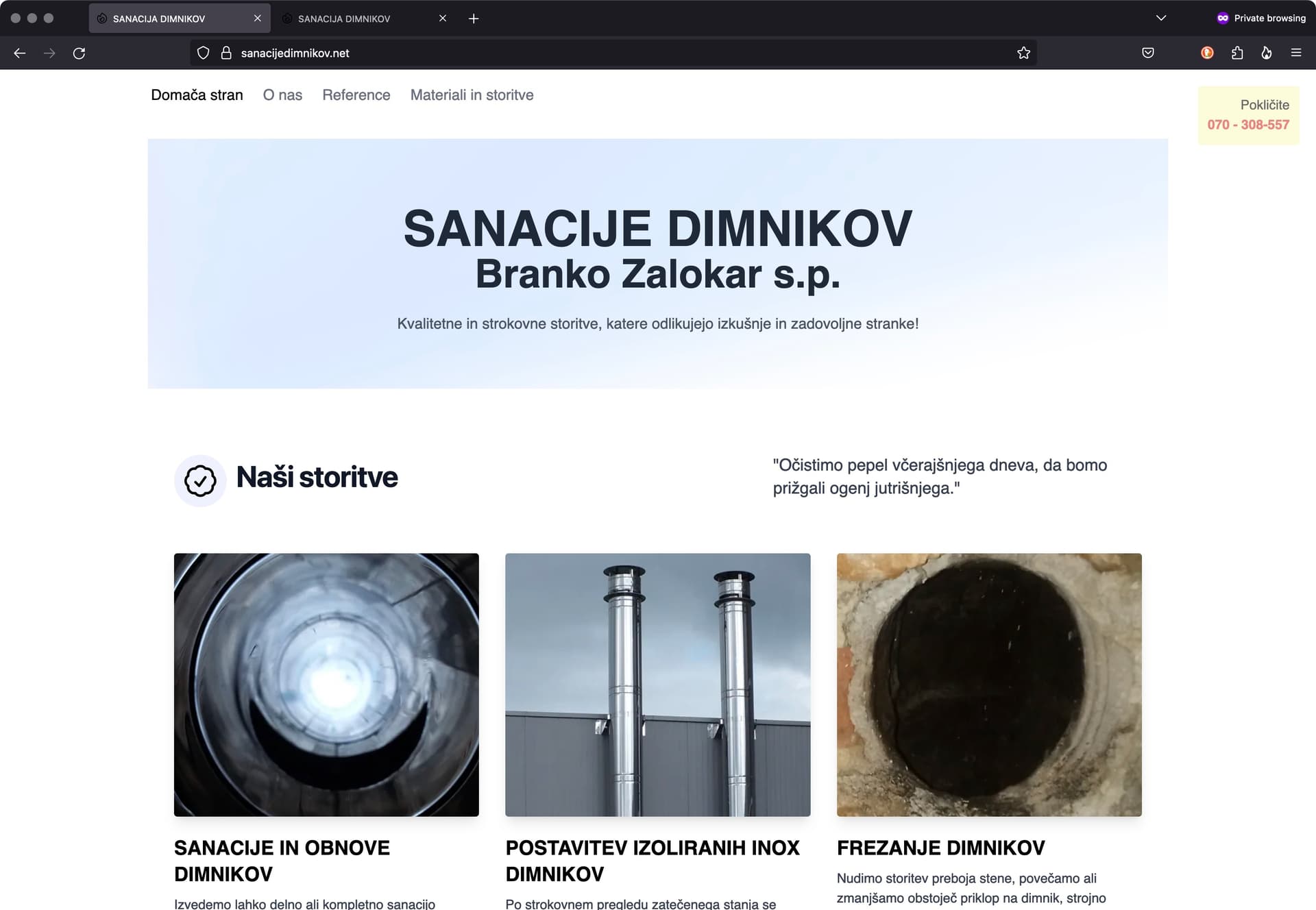

I have no issues accessing sanacijedimnikov.net or www.sanacijedimnikov.net
Wow, really? It is not working in Europe at all. I’m trying it from Slovenia, and it is just timing out.
Just did a test and requested it over my mobile provider, and indeed, the DNS resolution seems to work.
So, maybe my router is caching the DNS resolution or my Slovenian internet provider is doing something funky. Either way, thank you very much, I guess the issue is not my configuration but something on the wires. Will dig deeper!
This is certainly possible. Possibly even your computer/browser. Try a different browser, use a private/incognito window, flush DNS…
Indeed, restarting the internet router solved this issue. Wow, all those crazy caches everywhere…
