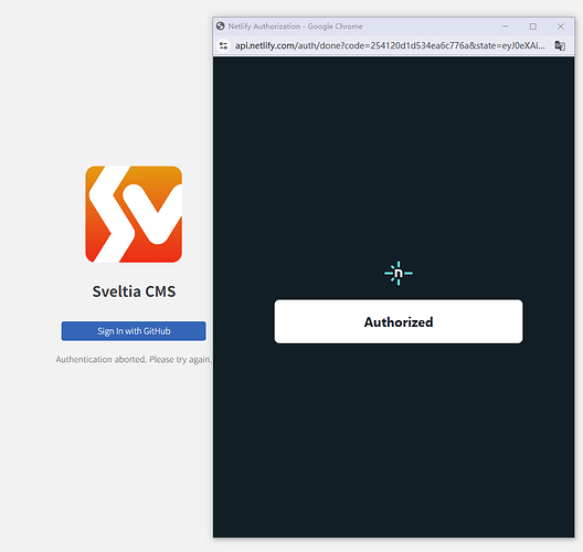

Authorized stuck, please help
When I switch from github pages to vercel deployment, the netlify Authorized verification window cannot be closed and I have not logged in to github successfully

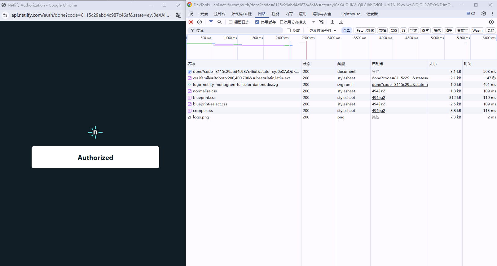

But it still stuck in Authorized window
When I use localhost to test (using Netlify CMS Oauth application), I can also log in successfully. What is the problem? It has troubled me for a day. Please help. Thank you.

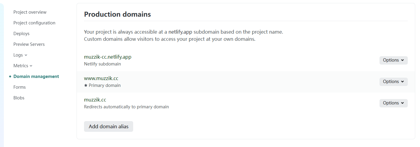

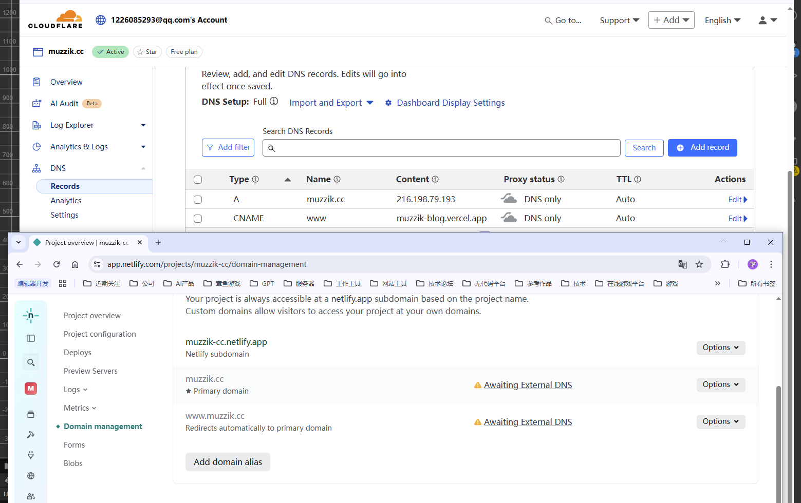

This is my Netlify and cloudflare domain configuration. I added vercel’s DNS record using cloudflare.

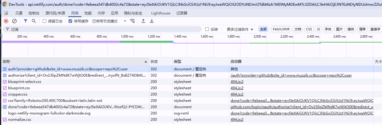

Complete list of Netlify Authorization network requests

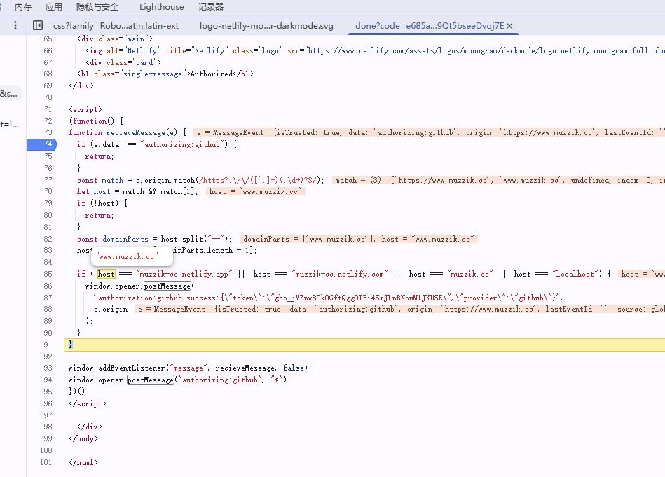

I checked it from the source code and found that the host is www.muzzik.cc and the if statement is muzzik.cc, which causes the error
Set the primary domain name to solve
