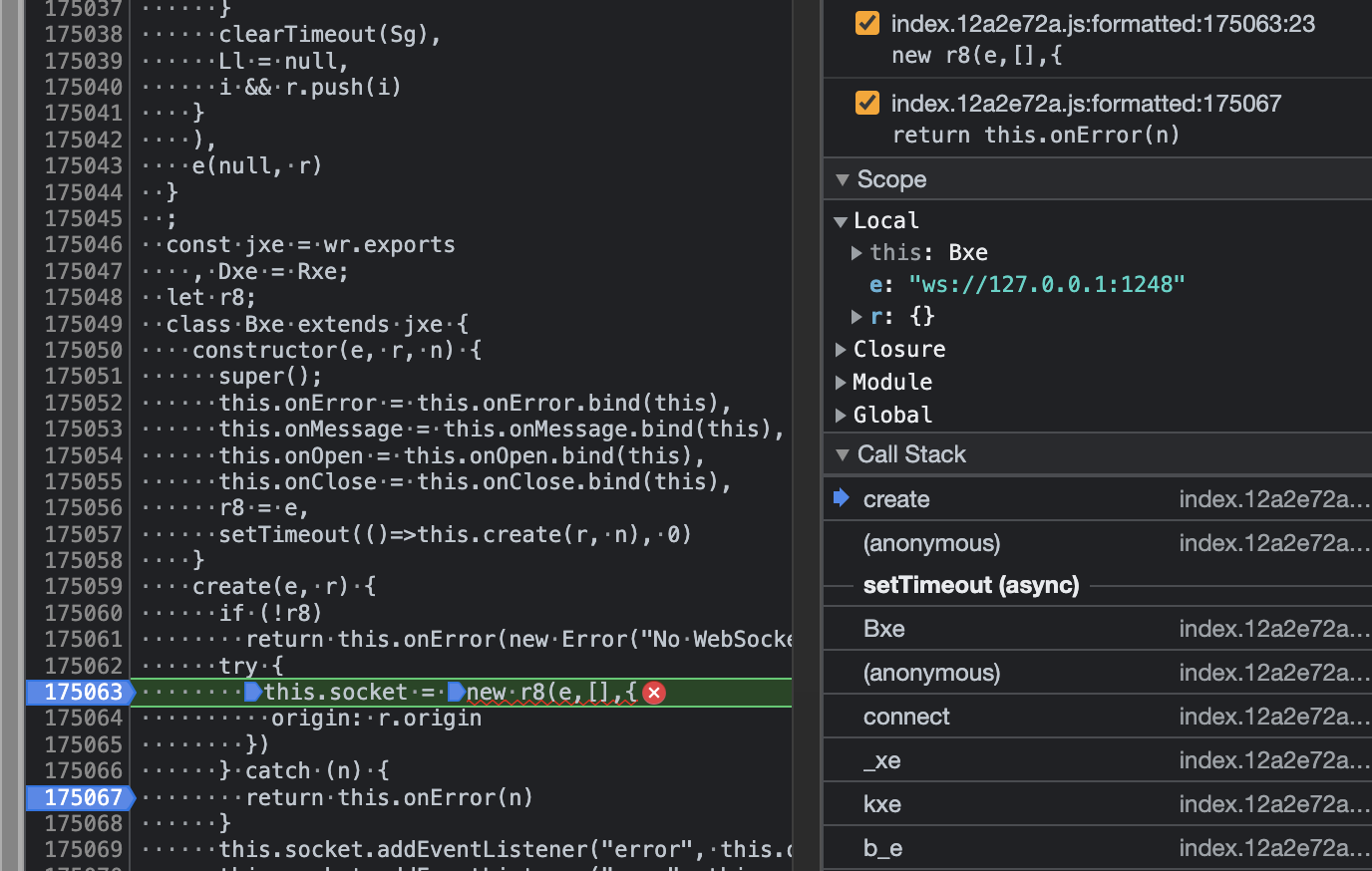

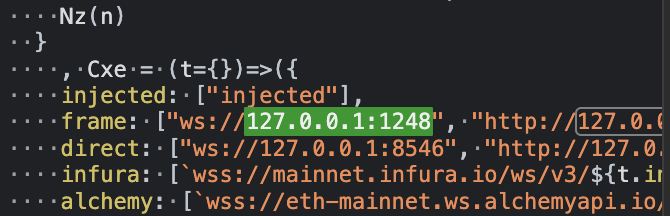

In any case, @MrDeadCe11, sadly we don’t know why your code is connecting to localhost either, from what we can see this seems to be done by something in your code itself than us. I added a breakpoint to where your code was throwing an error:
it turns out, the variable e is having the localhost value. Why? We don’t know. We can’t really debug a code that’s so highly minified.
However, I can see some hardcoded values:
