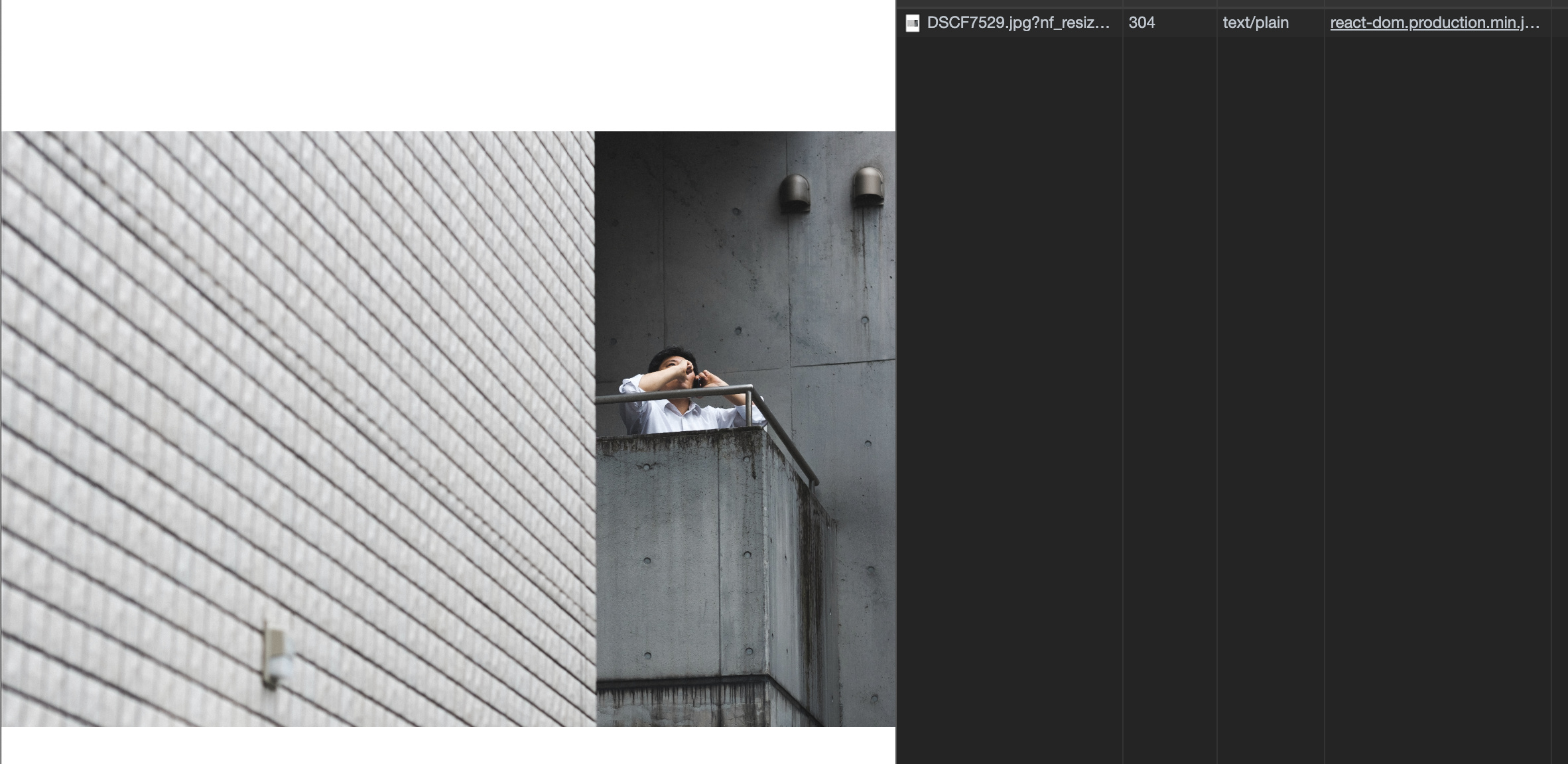

Weirdly, on the file-type being “octet-stream” — I’m still getting that after trying git config lfs.contenttype true and re-uploading, but when I reload the page once or twice, this changes to “text/plain”
Those 304 status codes indicate cached responses. Could you check Disable Cache up top on the DevTools Network tab?
@marcus thanks – I have checked disable cache and get the same result.
Yeah. I guessed that would not fix it.
