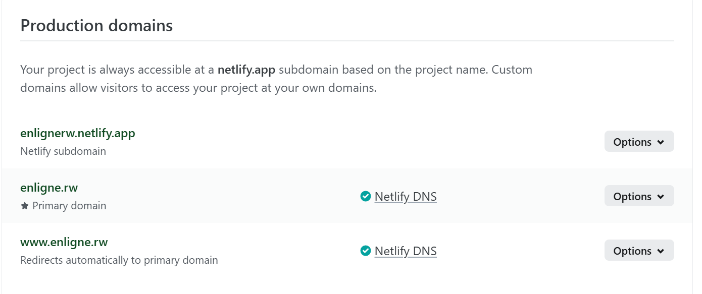

Hello, I am new to this. Deployed a website and gave it 24 hours too propagate yet when other people click the link they get the above mentioned error. The Netlify subdomain works fine however. This is happening in Rwanda but the website works fine in Kenya. Is there any fix I can use for this? Much thanks.
Your domain is indeed not pointing to Netlify. Please reset the nameservers of your domain at your domain registrar and then follow the instructions in Netlify UI.
