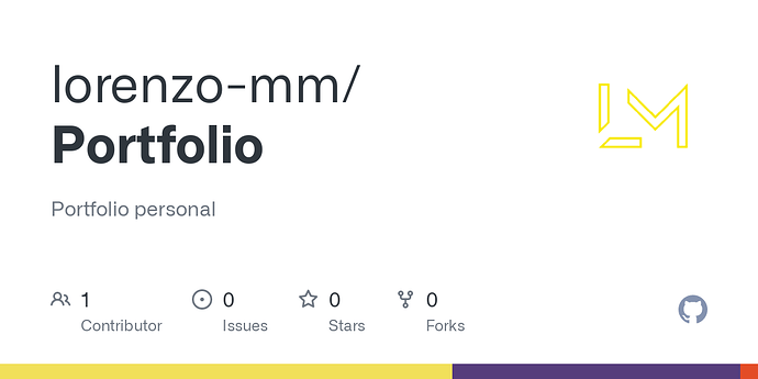

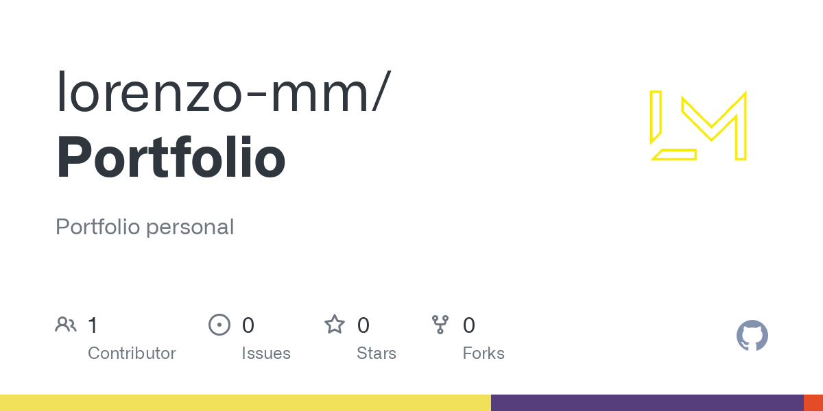

yes, I have my repository on github, I leave you the link
You’ve set the homepage property in package.json to an incorrect format:
  "homepage": "lorenzomunoz.es",
Try removing it altogether or set it to a url
"homepage": "https://www.lorenzomunoz.es"`
