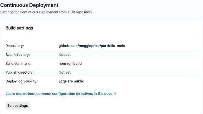

can you tell me what your build settings are set to in the netlify UI?
can you also post your package.json please?
This is what it is now. I have changed it a bunch of times trying to fix it but I think this is what it was before as well.

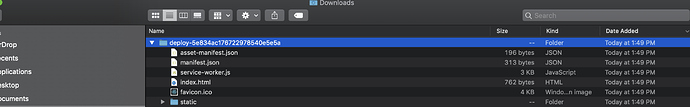

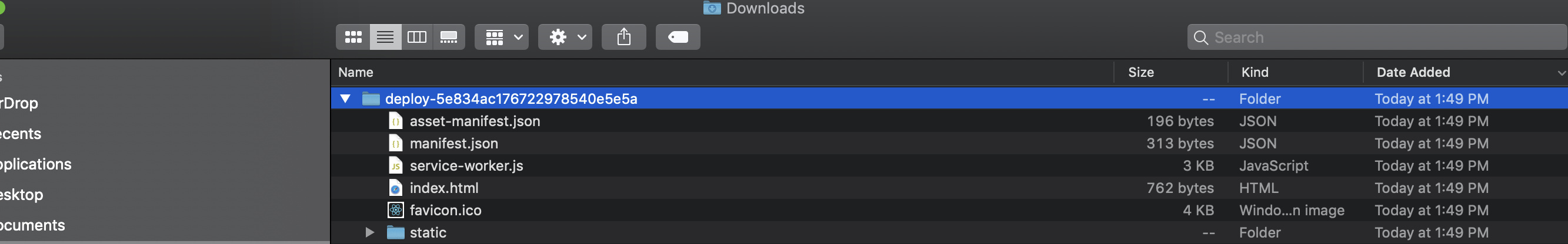

go ahead and follow the instructions here to download the site:
and then please post a screenshot showing your directory structure, so we can figure out exactly what is generated and why, so we can point the paths to the index.html.
looks like your publish directory should just be blank, can you try that and see if that makes the index.html show up?
still gave page not found
I’m not sure why exactly but it was react-router-dom. I had to change my app.js code to mostly match this: https://reacttraining.com/react-router/web/example/basic
then change my publish directory to /build.
