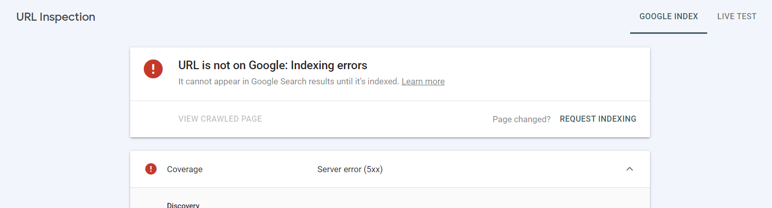

Hi,
This is all they show me:
I also noticed that Google Index seems to fail, but the live test passes:
There is no support option for Google Search Console, so I am unsure how to get the status code.

I think I know where the error is coming from. Since your site is static (it’s a Docusaurus site which is based on React), there was no reason for server side error codes. But i checked now, and you’ve enabled Pre-rendering: Netlify App. If you disable that, the errors should be gone.
Alright thanks. I will disable that.
The description of Prerendering looked appealing, that’s why I enabled it haha
Thanks again!
