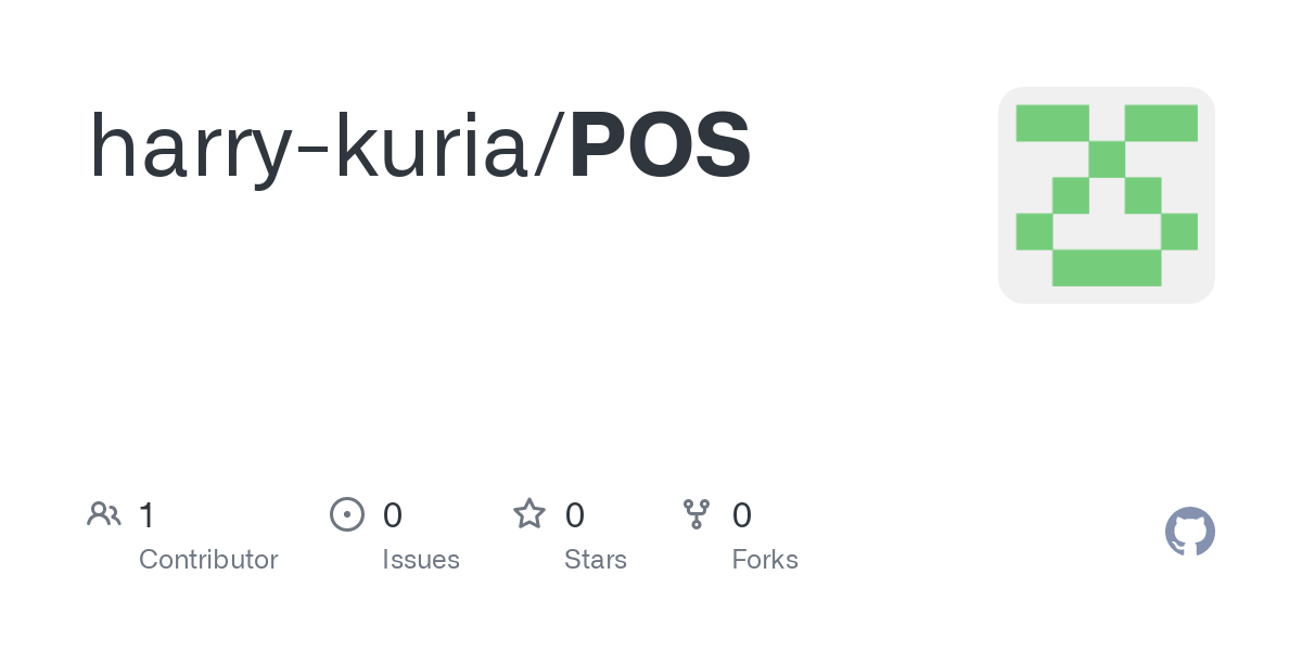

Here is a link to my project

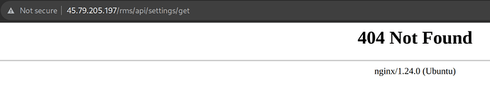

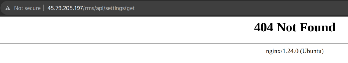

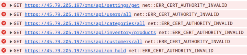

@Harrison23 Have you checked the developer console:
Those URLs don’t have a valid SSL Cert… but they also don’t exist:

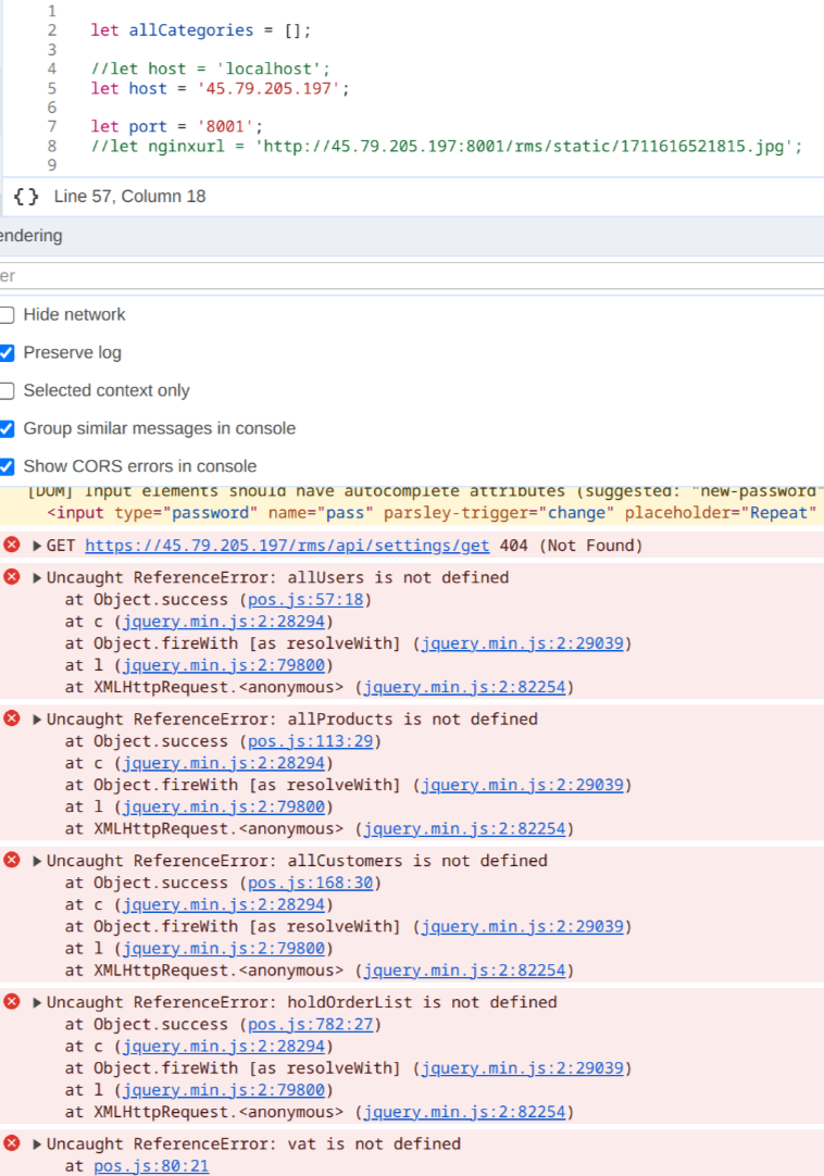

All I know from taking a quick look is that your original assertion that the site on Netlify is not loading JS is incorrect.
The site is loading and running the JavaScript, the JavaScript is just throwing lots of errors and you’ll need to make whatever adjustments are necessary to get it running smoothly.
