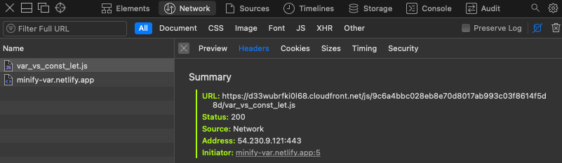

Here are 2 examples that demonstrate the problem very simply.
It’s the same very small and simple website, just using var in https://minify-var.netlify.app/, whereas it use const and let in https://minify-const-let.netlify.app/
Everything is explained in the website itself to see the original script and the one on CDN.
You will notice that var is minified whereas const & let are NOT.

Interesting find! Must be some logic in the minifier to not minify for const/let (491 v 762 bytes) as they’re both handled by our post processing (served from Cloudfront).
If this is important to you, right now, I’d advise minifying externally. Again, thanks for showcasing this!
