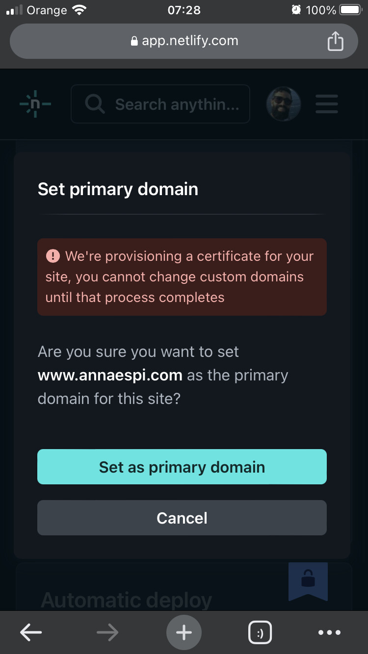

Hi @SamO ,
The site is annaespi.com and the domain is from google. The Netlify subdomain is xorriespistudio.netlify.app .
I have annaespi.com as primary domain and www.annaespi.com that redirects automatically to primary domain (annaespi.com) and I requested the Let’s encrypt certificate.
Then I realised I needed www.annaespi.com to be the primary domain and annaespi.com to redirect to that one, but since I requested the Let’s encrypt certificate, this change has been impossible.
Thanks for your assistance,
Àlex
Hi @lexbarba,
I see that the SSL Certificate provisioning has failed. Are you able to set www.annaespi.com as the Primary domain now within the UI?
I’m afraid I can’t. Still get the same error: We’re provisioning a certificate for your site, you cannot change custom domains until that process completes.
Hi, @lexbarba. We’ve made another change. Would you please try again now?
Hi @luke, still getting the same error.
Hi, @lexbarba. I’ve made the primary production domain www.annaespi.com now.
I cannot update the SSL as the DNS isn’t yet pointing to Netlify but the change has been made.
If there are any issues provisioning SSL after the DNS is updated or if there are any other questions, please reply here anytime.
Hi @luke , thanks a lot, but still not working.
DNS records were not ok and while trying to fix them, I ended up removing the custom domain… sorry… Now DNS records look okay, now www.annaespi.com is being served by Netlify as I updated it, but have again the wrong primary domain, that cannot be changed for the same reason: We’re provisioning a certificate for your site, you cannot change custom domains until that process completes .
Could you please do the same fix you did before? Thanks and sorry for the trouble.
