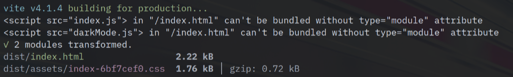

@codingwithsim It’s not a Netlify related issue, the files just aren’t found:
You’ll find the same thing happens when running npm run build
locally, going into your dist
folder and then running npx serve
You can also see why it is happening, (and how to fix it), in the messages that are shown when you run your build:
You’re using Vite and it wants you to put a type="module"
attribute on those script tags.
