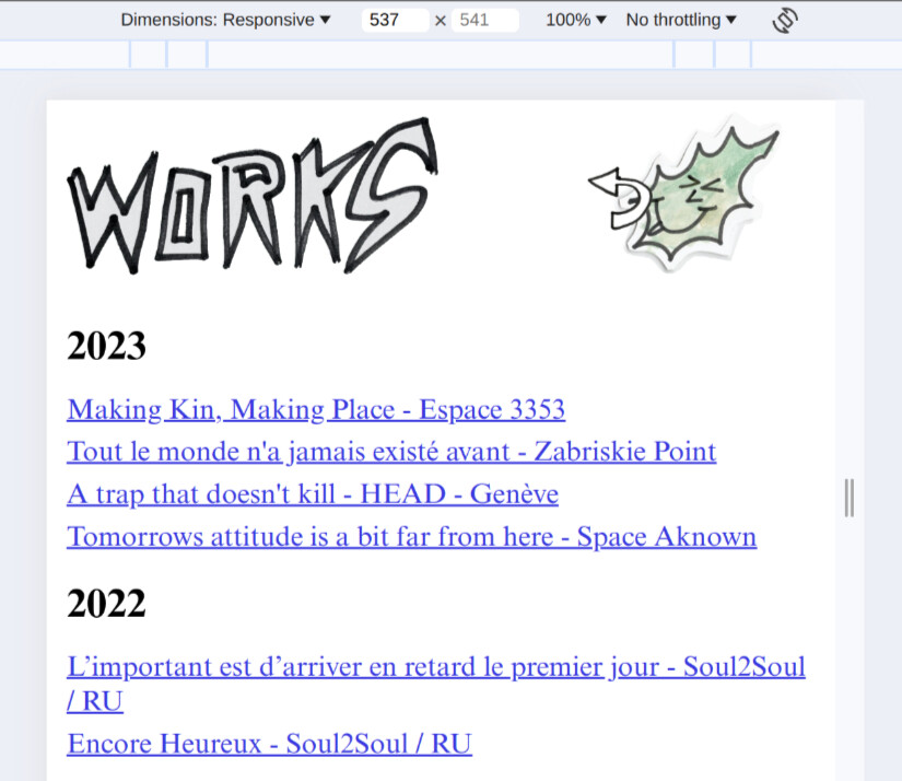

When I load the page initially at a larger size then scale down the lightbox continues to work, however it never switches to the “mobile” layout:
If I hit refresh, I end up with a different single column “mobile” layout:
As you mentioned, it’s in that layout that the lightbox doesn’t work.

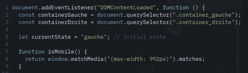

As I’d guessed you are running some resolution specific JavaScript:
It triggers if the page is below 992px when it is first loaded:
The most important part for this explanation is that it searches the page for links and hijacks their behavior so they operate in a kind of “Single Page Application” fashion:
