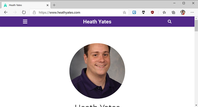

Sometimes I can see my custom domain up on my browser. However, when I try to access the my custom domain url via my phone, it is not showing it is up. Weirder yet, when it shows up on my browser, it is down for friends checking on my behalf states away. Other times they can see it, but I can’t.
What puzzles me is that it is up for my https://heathyates.netlify.app/ but only sometimes maybe working for www.heathyates.com

  • Last but not least here are some screenshots @fool that I think collaborate what you are seeing on your side by my colleague Kevin who has jumped in to see what IP are on his side when it is up or down:
Status Code: 404
IP Address: 206.189.73.52:443
However, you can see it up here:
Status Code: 200
IP Address: 104.248.78.23:443
