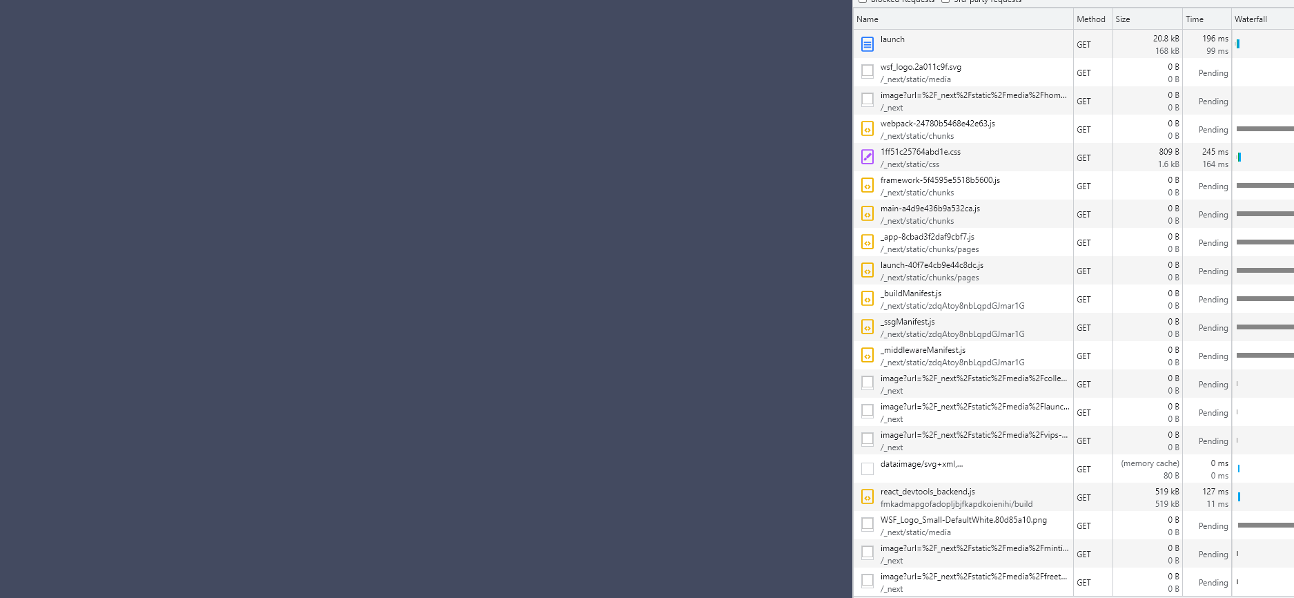

We have deployed a NextJS site to Netlify and started notice a couple of problems happening randomly on site load:
  • Sometimes many of the images http requests get stuck forever at pending state,
  • Also, sometimes the site JS served from Cloudfront CDN are empty.
This only happens while loading the site on Chrome or Safari. Firefox works fine.
This can be easily reproduced by force refreshing the website repeteadly, after a few refreshes the pending requests show up and images never get loaded.

Attached is the HAR file. You’re right, it only happens with cached files (mostly images and svg files). If you force refresh like 10 times in a second the problem appears, that’s the only way I found for reproducing it. Our main issue is that this happens randomly on site load.
