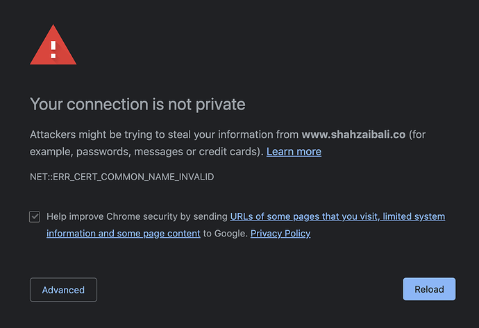

Going to domain with www not working properly. Bought the domain on GoDaddy and then used it on custom domain and DNS is being handled by Netlify. !
Screenshot 2020-05-16 at 12.53.05 AM|690x139
Anyone who can help me fix this please! Thanks

yes it does! but the only problem im facing at the moment is that when i try going to the domain with www. it shoes me
thisI have been looking into it but cant find any reasonable solution for this.

This looks to me to be an issue that Netlify has to address. If you’re on the free tier, you’ll just have to be patient until one of the techs picks up this thread.
Hey @Shahzaib_Ali, I’m not sure why it took so long for us to provision an SSL cert for your site, but everything looks good to me now. Is that what you’re seeing?
Hey Jen,
I dont think it took more than 2 days, although the problem earlier i was facing was with Name Servers. Nevertheless, it works perfectly now. I’m updating my portfolio
