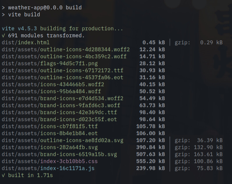

If you run your Build command locally (npm run build, which runs vite build) you’ll see:
Your project generates its content into the default Vite directory of dist
You currently have your Publish directory set to ./build/ (which is a source directory).
