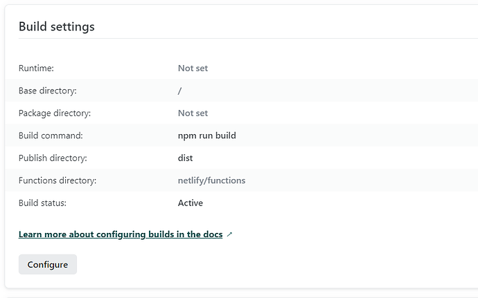

Hi, even I am facing the same issue as above - After deploying the client (using Vite) directory from my project, it says “published” however I see a blank page.
here is the published link - https://main--stylexpk.netlify.app/
here is my github repo - GitHub - Pranit160997/StyleX: Experience luxury with Style X rental
Any help would be highly appreciated! TIA

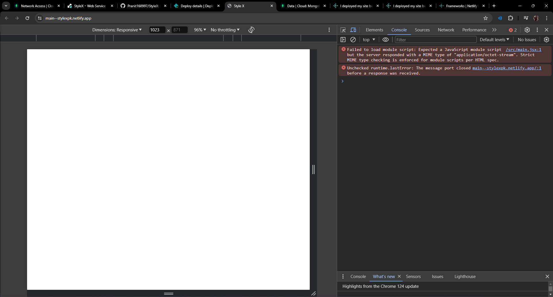

This is what I see on my console, PFA -
You published the source code not the built site @Pranit160997

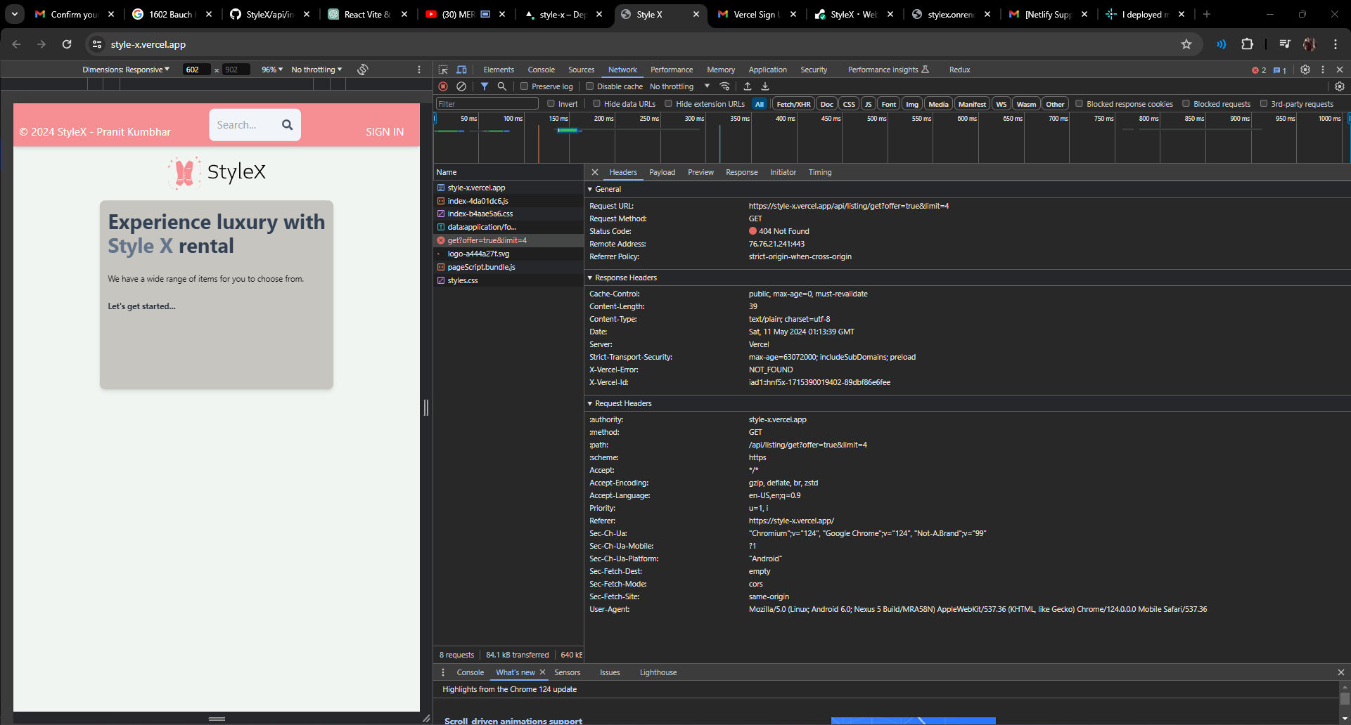

I also tried publishing the built site - dist folder in my case. It has connectivity problem to my hosted backend on render. Would you be help me navigate the issue?
What sort of issues?

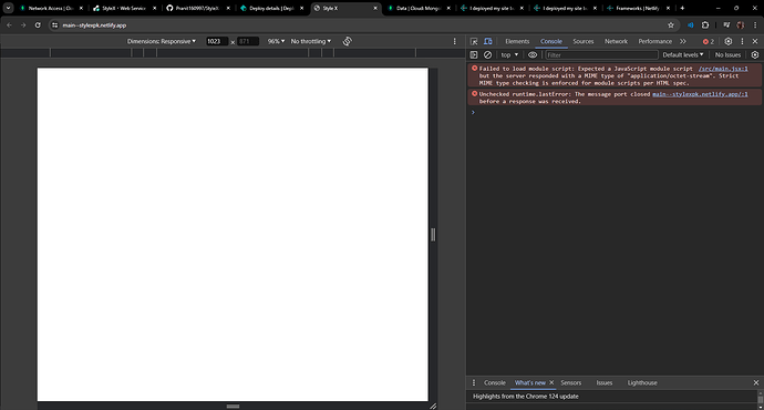

This is what I see -
The error is I should be able to see some pictures here, which is a get request
My backend is hosted on - https://stylex.onrender.com
and I am able to connect to it locally from my frontend but I see this error from my hosted frontend (also tried hosting frontend on Netlify and I see the same error).

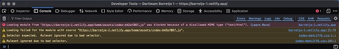

Hi there,
As many above I also see blank page when it says that my project is ‘published’
Here is the published link: Barretje 1
Here is the github repo: Github repo

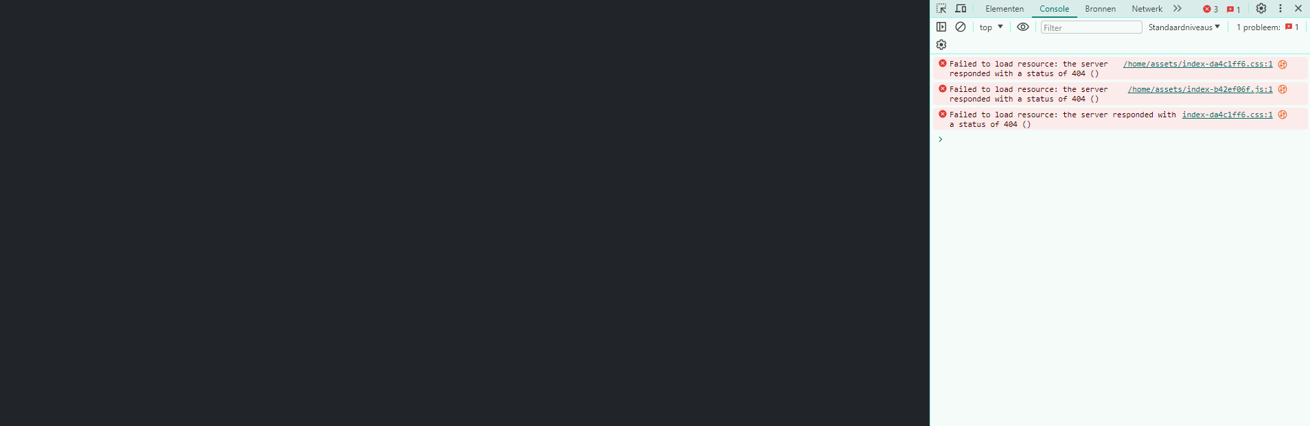

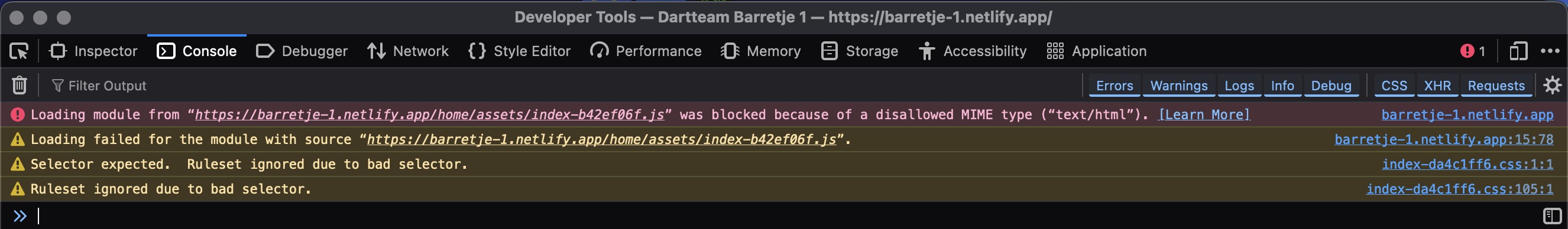

screenshot of the console:
If someone could help me out, that would be very much appreciated

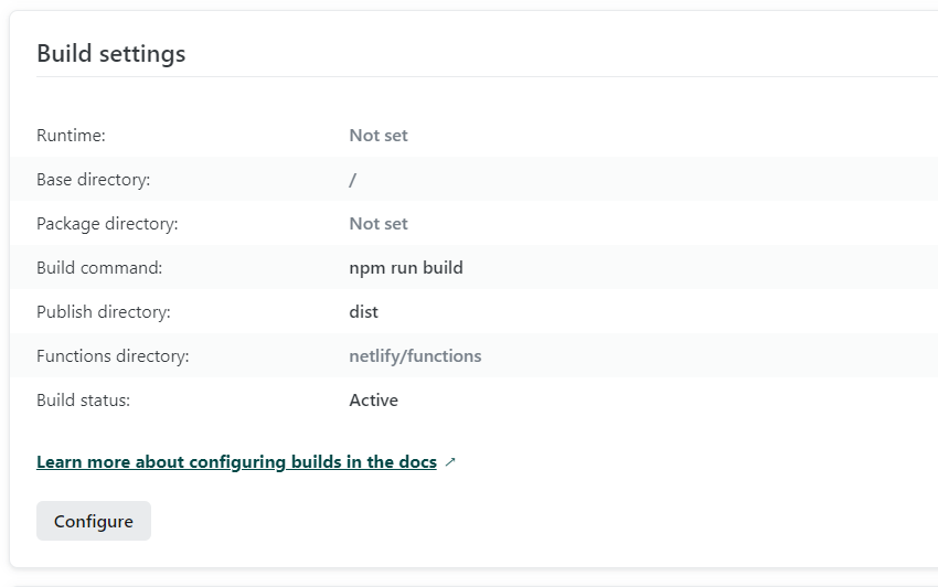

screenshot of the build settings:
If you look at the console you’ll see the issue @kevcraeck.
The solution, in case it doesn’t jump out at you, is to remove line #6 where you’ve set base from vite.config.js
@dig I tried removing line 6, but after deployment I still see a blank screen.
