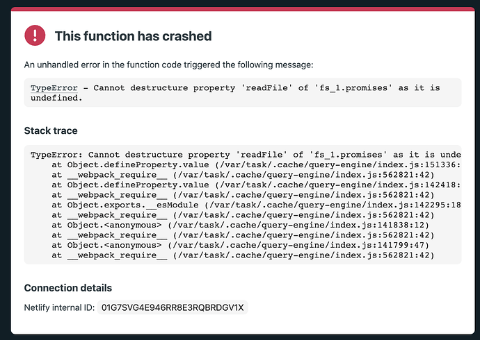

Hey @ynherb299 , I’ve checked your site and it looks like you are not getting the same error that the original Forums member posted in their initial post – we’re seeing a TypeError on the function error page:
Typically, this kind of error indicates an issue in the code and not within Netlify. We suggest that you take a look in the code (likely in the place described in the stack trace shown in the above screenshot) for further debugging.

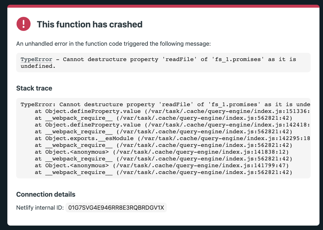

Hi, I also ran into the same issue for a Gatsby SSR generated page. We also set our node version to 16 in our .nvmrc. Screenshot of the error:
I set AWS_LAMBDA_JS_RUNTIME to nodejs14.x and re-deployed and the issue was fixed.
