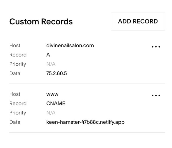

I purchased a domain name on Squarespace and configured CNAME and A DNS records for my Netlify website.
Domain: divinenailsalon.com
Website: https://keen-hamster-47b88c.netlify.app/
Currently, only the domain www.divinenailsalon.com is active, while divinenailsalon.com is still not active (awaiting external DNS). I have waited for more than 24 hours, but it is still not active.

I read the documentation for configuring external DNS that only requires configuring type A and CNAME for the Netlify website. I have configured it as instructed for 24 hours, but my website is still not active. If I configure external DNS, I don’t need to delete the Squarespace nameservers, right? I have attached a screenshot for easier review.
If you are using external DNS you need to remove the Netlify name servers from Squarespace
divinenailsalon.com.	4502	IN	NS	dns1.p04.nsone.net.
divinenailsalon.com.	4502	IN	NS	dns2.p04.nsone.net.
divinenailsalon.com.	4502	IN	NS	dns3.p04.nsone.net.
divinenailsalon.com.	4502	IN	NS	dns4.p04.nsone.net.
Also ensure you remove the domain from the Netlify Domains page in the dashboard.
