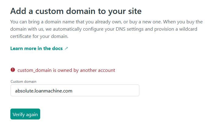

I have a site on an account with a custom domain (absolute.loanmachine.com) but I want to use this domain on a new account. I removed the custom domain from the old account but when attempting to use the domain again in the new account the following error appears:
I double checked to make sure the custom domain was removed from the old account (it is) so I’m not sure whether it’s a waiting game or if I did something wrong on my end. I could add it back to my old account but that would defeat the purpose of this post.

Please let me know the name of the Netlify site where you are trying to add the domain “absolute.loanmachine.com”. I want to make sure I understand what you mean by “new” account and “old” account.
The issue is that there was a DNS zone set up for loanmachine.com under a third Netlify account, one owned by someone named Scott, but with a different email address.
I’ve deleted that DNS zone now (it wasn’t in use).
So now you can should be able to add your domain to flamboyant-noyce-b73107. After you remove it from agitated-heyrovsky-b16102, that is.
