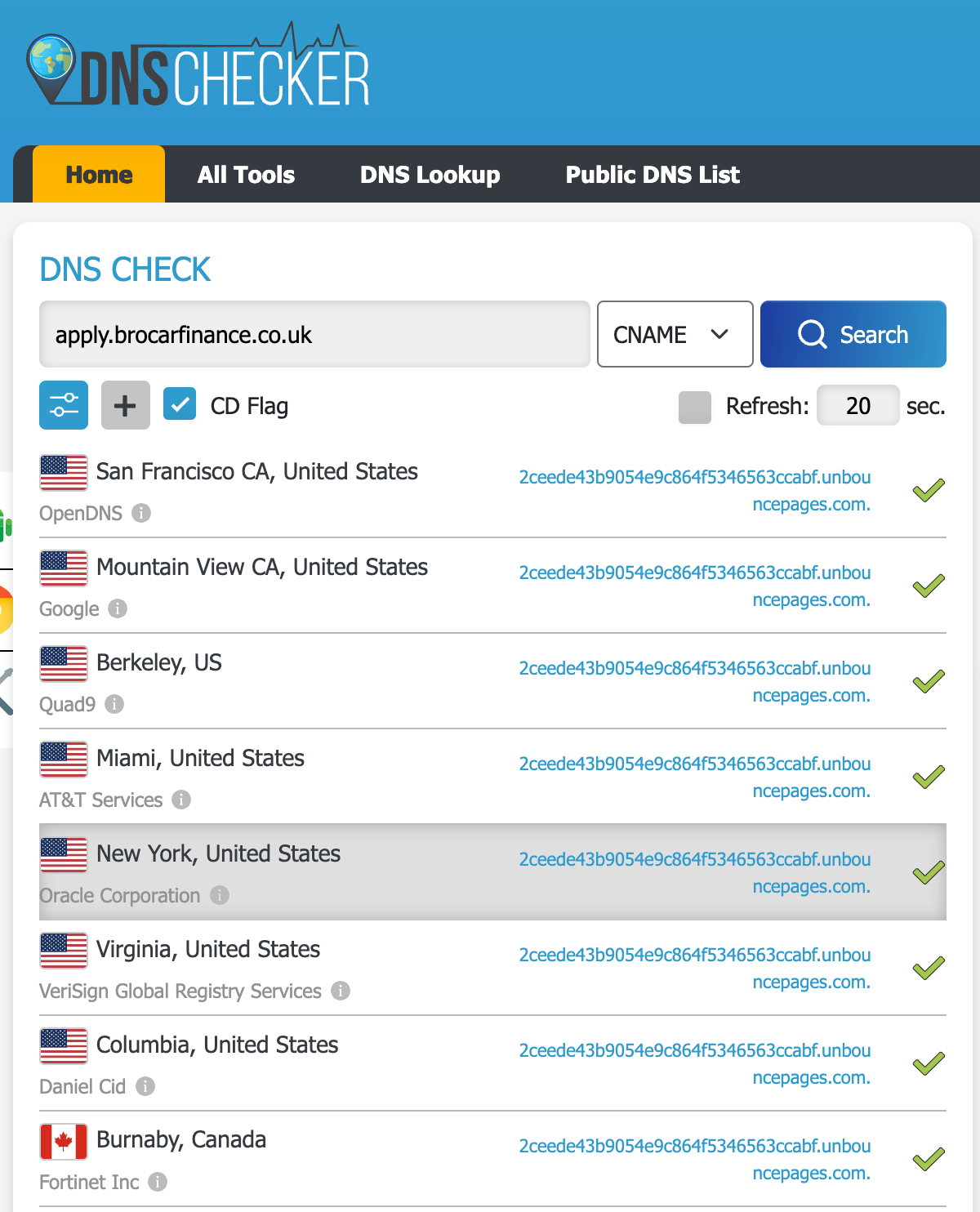

I do see that the CNAME Record has propagated:
