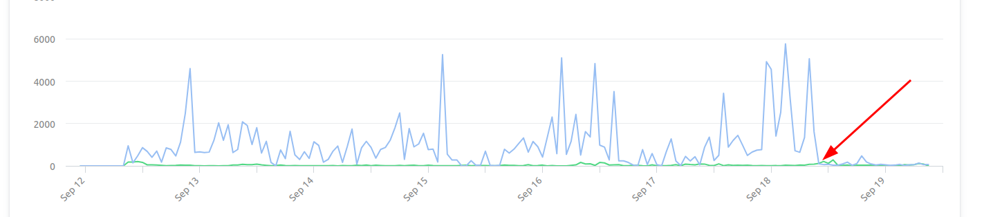

It’s still early to say whether it fixed everything, but it definitely the invocations to the Next function, as you can see from the drop in 404 invocation in the image below (arrow marks the time when I deployed the solution).

@fvieira So yesterday I implemented this 404 handler exactly as you showed and I tested it and did receive the 404 page in return. But today I still see no reduction in function calls!
You can see just about as many today as in the previous days.

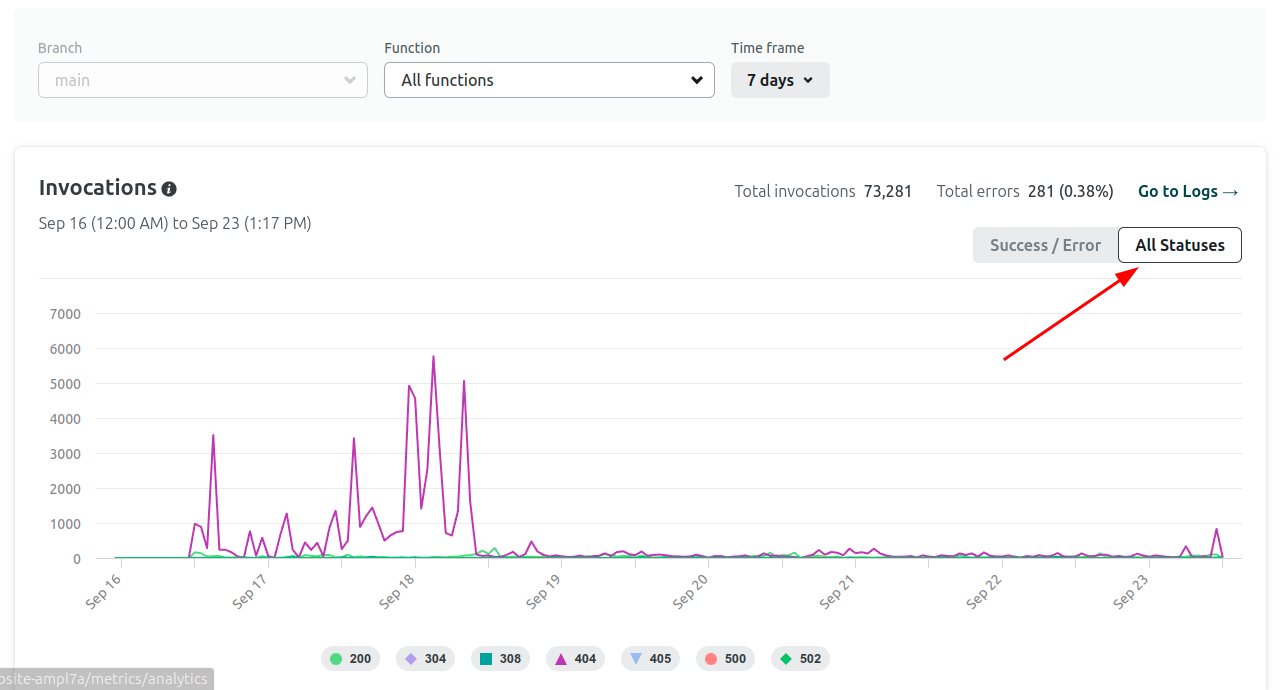

Are you sure you are not seeing the “Last 24 hours” view instead of the “7 days”? Because I see in your screenshot 12:00 AM which only shows when you are seeing the “Last 24 hours” view.
Also check on the All Statuses if you see any drop in 404 errors like I do.
I think this is the view you’re talking about:
The vertical red line is around the time I committed the code with the 404 handler, and the 404’s do not go away, as in your graph. And the “Top resources not found” analytic only lets me view the whole month, so I can’t even filter by the past 24 hours to see if, perhaps, there are just as many 404’s, but following some long tail pattern that I missed in my regex.
