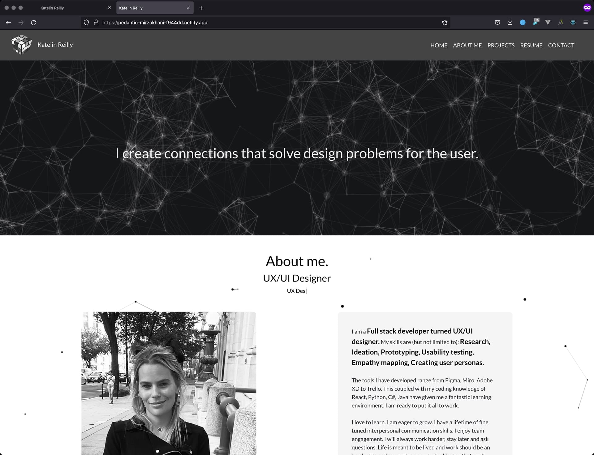

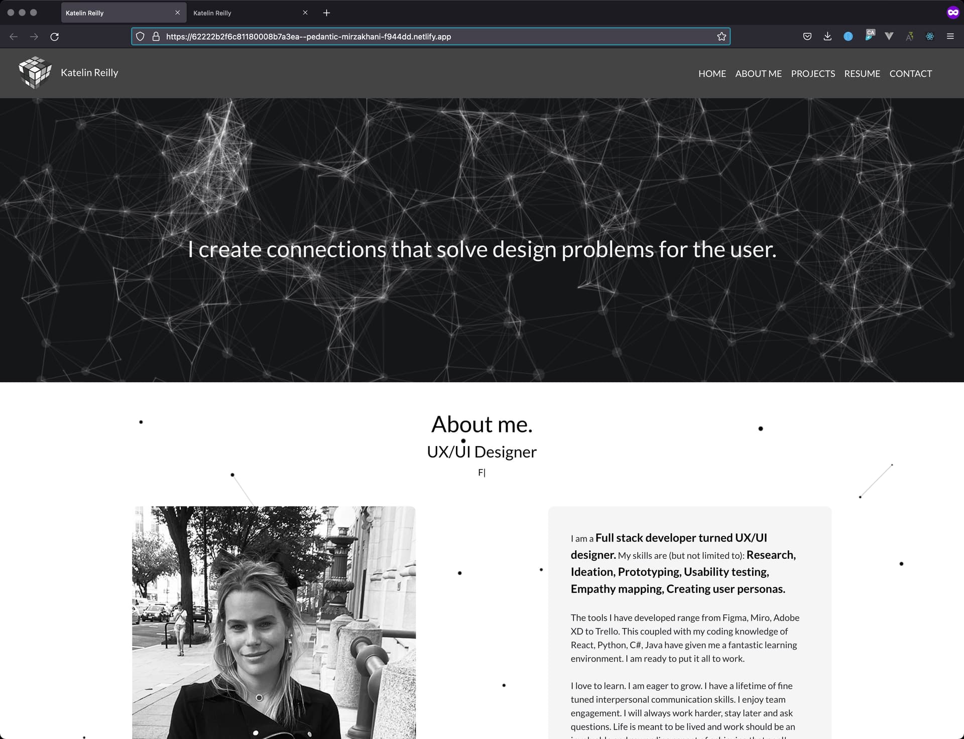

https://62222b2f6c81180008b7a3ea--pedantic-mirzakhani-f944dd.netlify.app/
For some reason it fails after working. The website will work on my domain, then stop. It also continues to work on preview . Any thoughts as to why it stops deploying the site and especially the pictures.

I see the same thing on https://62222b2f6c81180008b7a3ea--pedantic-mirzakhani-f944dd.netlify.app/ and https://pedantic-mirzakhani-f944dd.netlify.app/.
Are you using a custom domain as well? Is that where you are not seeing the current version of the site? If so, what is the custom domain?
The custom domain is katelinreilly.com it’s sometimes working and other times says, “site is under construction”.
