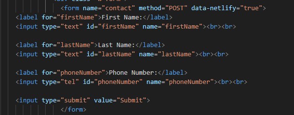

Please copy the entire <form> element and surround it in `` tags
Screenshot 2023-05-22 104826

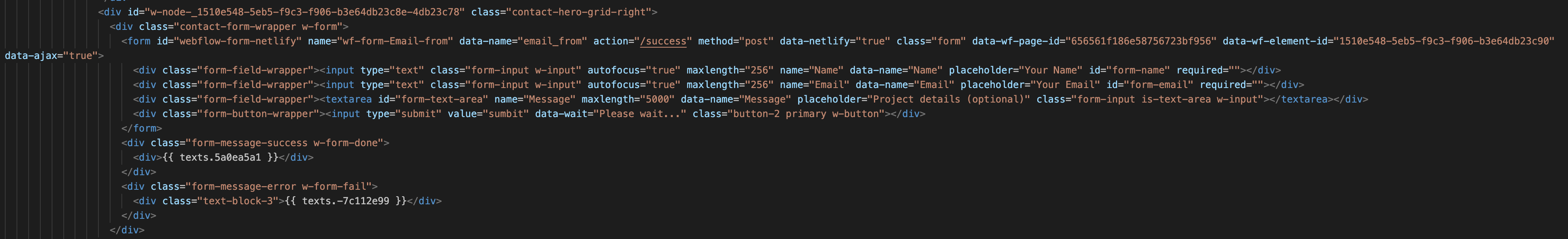

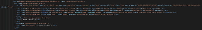

Hi sam! I having the same issues but I think I’ve tried so many things and I can’t seem to get it to work. Could you take a look at this screenshot of my code and let me know if you spot anything wrong.
Form detection is on
Thanks!

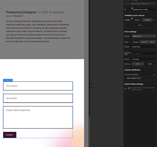

Here’s a look at how it is formatted in Webflow
Without a site name, we won’t be able to check anything useful here.
Thanks for the promptly reply! Here’s the site michellealexa.com the form is under the about page
