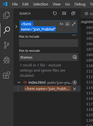

In the public folder, there is only one .html file with the form join_Prabhat

Your current deploy has NO form with that name - I just downloaded it and looked.
So I think the problem is that you deployed it once awhile ago in an html file, and that is the definition your current javascript submission uses. Please create an explicit, separate, html file with the definition including all fields that might be submitted via your javascript submission.

The solution to this issue:
Removed one form from the page (2nd one was the contact form in the footer) and the 1st form (join-Prabhat) worked. As I had already guessed that
