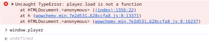

@BhargavRajGuru Check the errors that are visible in the developer console, e.g
Uncaught TypeError: player.load is not a function
A wild guess, (because it’s extremely hard to debug from a partial screenshot alone), is that’s the code that implements the <tgs-player> and it’s not loading correctly.
That’s the only error on developer console, there are total 9 error but all are related to player.load, and you are correct, I think it is the <tgs-player> which is not loading correctly.

The error is precisely as it says, you have code that is trying to execute methods on player and it is undefined.
The offending code is throughout your HTML file.
It is triggered when an event 'wcThemeChange' is broadcast by code in wowchemy.min.7e2d5311a27ca3dd5ea3d30b628ccfa8.js:
It’s not that some code is just loading slow either, since it remains permanently undefined:
So we know whatever code should be there to run it, simply isn’t there at all.
The problem can thus be summed up as “your site is missing a dependency”.

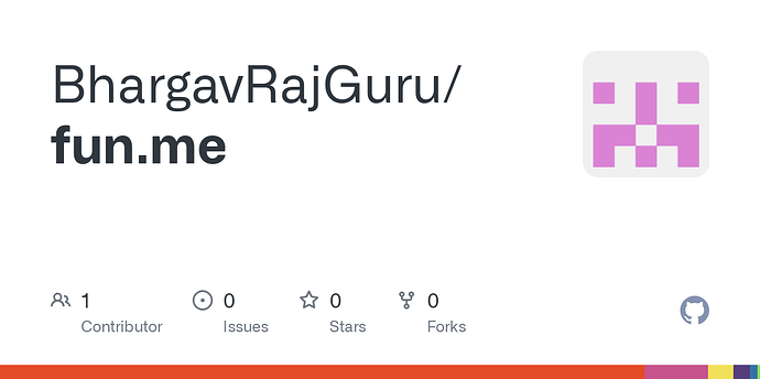

I can see references to lottie files in your repository:

Checking your codebase I can see references to:
<script src="https://unpkg.com/@lottiefiles/lottie-player@latest/dist/tgs-player.js"></script>
For example:
So that seems to be how your site loads it directly from the CDN.
However if you search the HTML source of your homepage, you will find that file is not included in there anywhere, which also evidenced by:
^ Nothing is loaded from unpkg.com
Obviously it won’t work, if it isn’t loaded.
You will need to edit your site to ensure that the dependency it requires is actually referenced on pages that try to utilize it.
