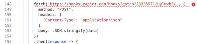

Trying to submit a netlify form but we get a submission error. We chwck console and get the following error From Console: (index):165 Error: TypeError: Failed to fetch at HTMLFormElement. ((index):148:7)](Submission error. Check console. From Console: (index):165 Error: TypeError: Failed to fetch at HTMLFormElement.<anonymous> ((index):148:7) )
Any advise and support appreciated.
@ARC The alert that says “Submission error. Check console.” originates from your own code:
The error as you’ve found is:
Which is from your fetch call:
You can check the ‘network’ tab to see the request details:
Check the details of the Zapier URL and any required values for submission.
