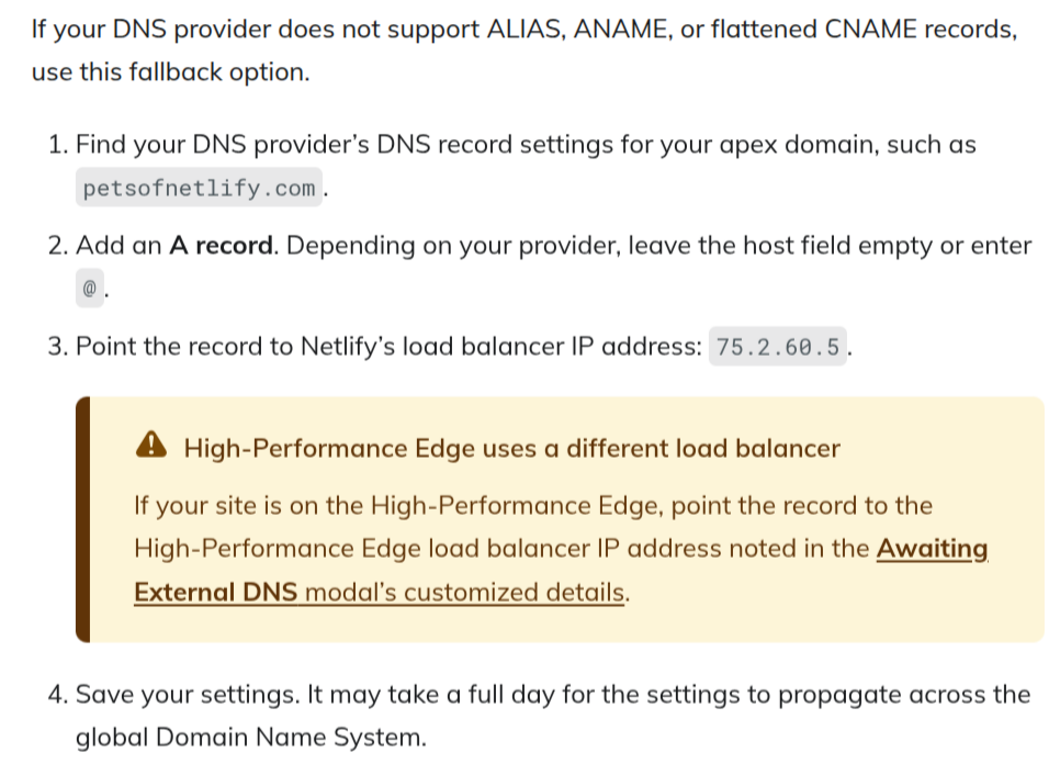

@Abdullahi_mahad_Dahi Delete the 99.83.190.102 record which is incorrect:
The IP address you mention, 99.83.190.102, is incorrect. You’ll want to remove any A record pointing to that address.

Please delete the A record for 99.83.190.102. That should resolve the issue but if not, please let us know with a reply here.

Just delete 99.83.190.102
Only 75.2.60.5 is required, as per the Netlify documentation:
https://docs.netlify.com/domains/configure-domains/configure-external-dns/#configure-an-apex-domain
Please refer to the documentation in future, not just AI hallucinations.
