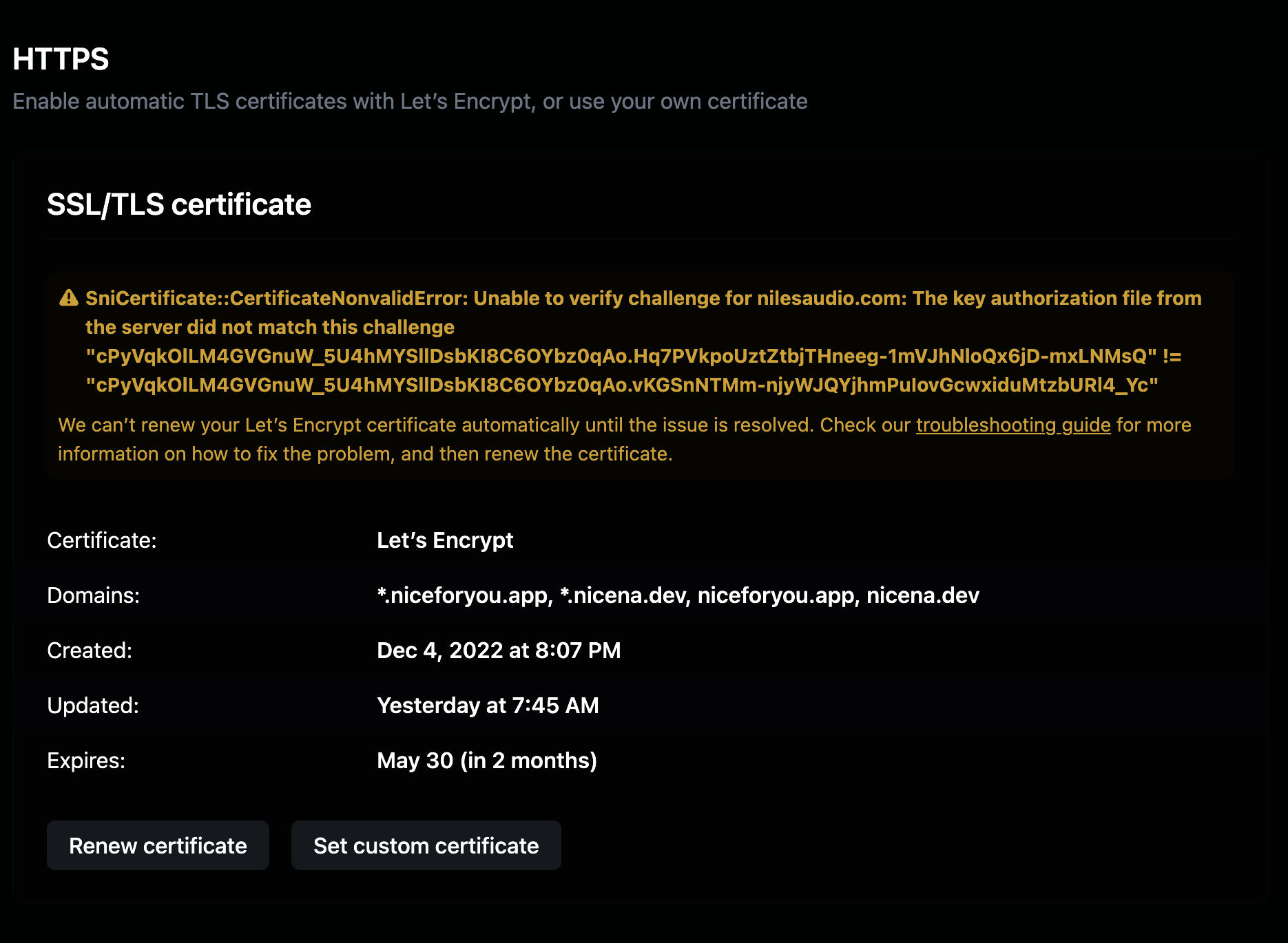

Here is the error message for one of the sites in Netlify. I’m at the point where I think deleting the site and recreating it is the best option… won’t let me remove the domain.
Any thoughts?
SniCertificate::CertificateNonvalidError: Unable to verify challenge for nilesaudio.com: The key authorization file from the server did not match this challenge “cPyVqkOlLM4GVGnuW_5U4hMYSllDsbKI8C6OYbz0qAo.Hq7PVkpoUztZtbjTHneeg-1mVJhNloQx6jD-mxLNMsQ” != “cPyVqkOlLM4GVGnuW_5U4hMYSllDsbKI8C6OYbz0qAo.vKGSnNTMm-njyWJQYjhmPuIovGcwxiduMtzbURl4_Yc”
We can’t renew your Let’s Encrypt certificate automatically until the issue is resolved. Check our troubleshooting guide for more information on how to fix the problem, and then renew the certificate.
For all three domains I believe the AAAA records are the likely cause as they are not Netlify assigned IPv6 records.
Try removing these records.
