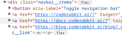

In terms of the site ending up at the subdomains, one reason that occurs is that your links point there, which is why you end up there even when on the .netlify.app URL.
