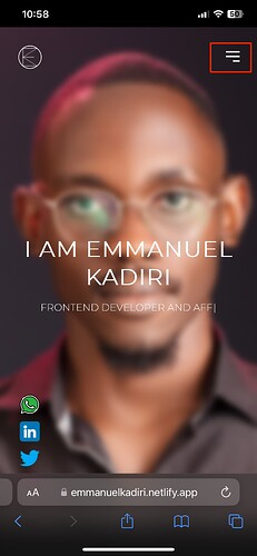

Were you able to resolve the issue? I ask since when I check the site on my phone the mobile navigation (hamburger menu) appears to be working:
After clicking on the menu button I see:
If I click on any of the nav links it takes me to the proper page (such as the about page).

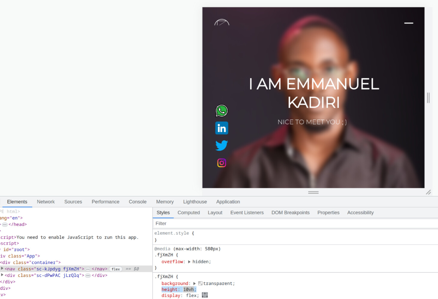

@EmmaKD2047 One thing I did spot, which is likely unrelated, is that the 10vh specified against the header causes the logo & hamburger menu to get get truncated when the viewport height is shorter:
