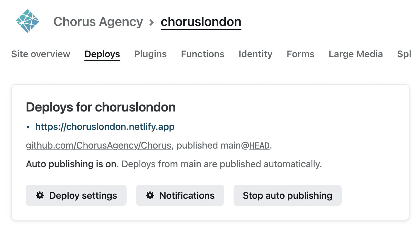

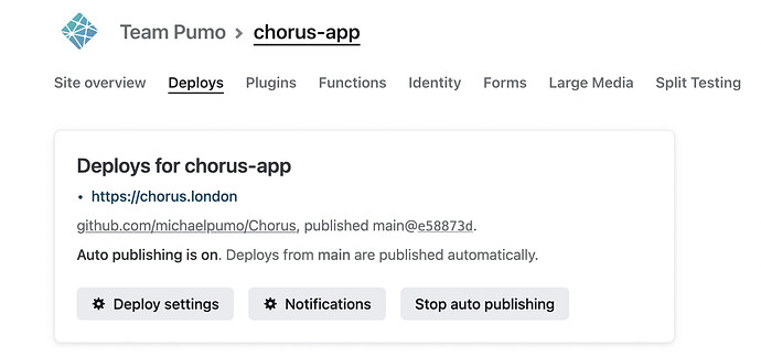

so, looking at this, chorus-app is linked to the github repo github.com/michaelpumo/Chorus and the choroslondon site is linked to the github repo github.com/ChorusAgency/Chorus
both have had recent deploys, but it looks like the choroslondon site has had a newer deploy, maybe about half an hour or so ago. so far so good.
but the sentiment that both sites are coming from the “same” codebase isn’t correct, as they are linked to different repos.
i have no insight into how the copy repo was generated :thinking: but even if the html pages or whatever content you have or building (as i can’t see either repo’s contents, i’m not sure how the end result is coming about) but there can obviously be major differences from repo to repo even if the content is the same, that is, you can have different dependencies listed out in a package.json, using different libraries, different internal settings set through our UI etc, you get the picture - bottom line is, there must, logically, be some difference between the two.

The repos that you’ve linked are actually the same repo. If you click both of the urls, you’ll notice that they both redirect back to https://github.com/ChorusAgency/Chorus.
I believe the reason for the difference you’re seeing on your side (i.e. the fact that one has the link https://github.com/michaelpumo/Chorus and the other has the link https://github.com/ChorusAgency/Chorus) is because Michael built the first site (https://chorus-app.netlify.app/) and set up the build from the repo when it was under his GitHub account initially, before transferring the GitHub repo over to our GitHub user/account.
I set up the Netlify-Github repo link on the https://choruslondon.netlify.app/ version of the site yesterday when the repo was located under the ChorusAgency user/account.
The reason for the more recent deploy on the choruslondon version is I triggered the webhook that is specific to this site to make a change to the content based on a change in our CMS. This triggering of the webhook for only choruslondon (and not chorus-app) has taken them out of sync, but otherwise they’d be identical.
Changes made to the repo at https://github.com/ChorusAgency/Chorus are triggering rebuilds on both versions of the site too, which you’d expect not to happen if they were different repos.

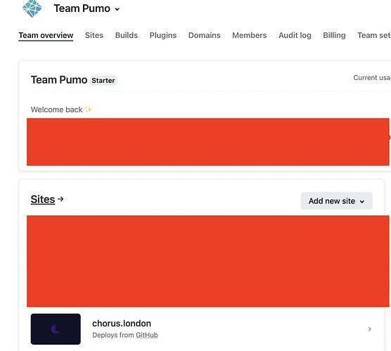

poking a little further, (with some things obscured for michaelpumo’s privacy, who has a few other sites in their account)
the ChorusLondon account only shows one site.
it seems that the site you are referring to is very much still in the MichaelPumo account. Ergo, I feel pretty sure these are two sites in two teams linked from two different repos. :thinking:
