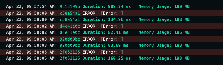

The error in the function log isn’t informative as it looks like
I believe the error is a red-herring. We had someone ask about 404s throwing errors and the answers given by devs was:
The log line is produced here: https://github.com/netlify/serverless-functions-api/blob/824fc1ecdcbc5dd3465f135c238bae56cbbab6d0/src/context.ts#L122
And the waitUntil call stack is:
    at Object.waitUntil (file:///var/task/___netlify-bootstrap.mjs:2:21727)
    at Object.trackBackgroundWork (/var/task/.netlify/dist/run/handlers/request-context.cjs:137:17)
    at trackedFn (/var/task/.netlify/dist/run/next.cjs:510:28)
    at /var/task/node_modules/.pnpm/next@15.2.4_@babel+core@7.26.9_@opentelemetry+api@1.9.0_react-dom@19.0.0_react@19.0.0__react@19.0.0_sass@1.86.0/node_modules/next/dist/lib/batcher.js:45:38
    at process.processTicksAndRejections (node:internal/process/task_queues:77:11)
which is for next-runtime internal tracking of Next’s background work - the tracking itself does work, but Next or customer seems to throw/reject the work with “Nothing” error (?) as this is what is being logged to stderr:
ERROR  [Error: ]
I have some ideas here to check - this might be result of some briliant Next.js / React ideas to use throw as “clever” execution control and not indicate actual failure anywhere, but given low prio it will probably have to wait a bit until more urgent escalations are handled
Once waitUntil was rolled out, next-runtime automatically started using it because it was ready for it.
Previous handling in next-runtime was not logging rejected promises, while waitUntil does so this is pretty good explanation why it suddenly started to show in logs. Maybe we should add silencing of a promise to next runtime to restore previous behavior (and potentially just debug log it, so it doesn’t confuse users) - likely things were throwing/rejecting before - it’s just now it’s being actually logged
I’ll check the rest of the issue shortly…
