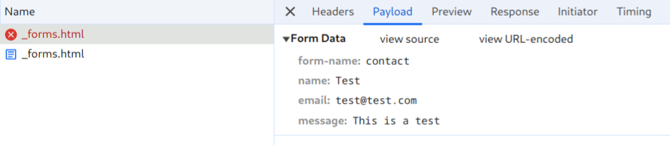

This is because you didn’t ONLY change the input.
Stepping through reveals the issue…
Using your form to do the POST results in the 404:
Visiting the same static HTML URL directly with a standard GET results in:
The payload values submitted by the POST were:
Viewing the source of the form shows as you supplied above:
The name of the form is different, and contact !== feedback.
Netlify will be rejecting POST’s to form names that do not exist and responding with 404.
Ensure the form-name is consistent in all places.
