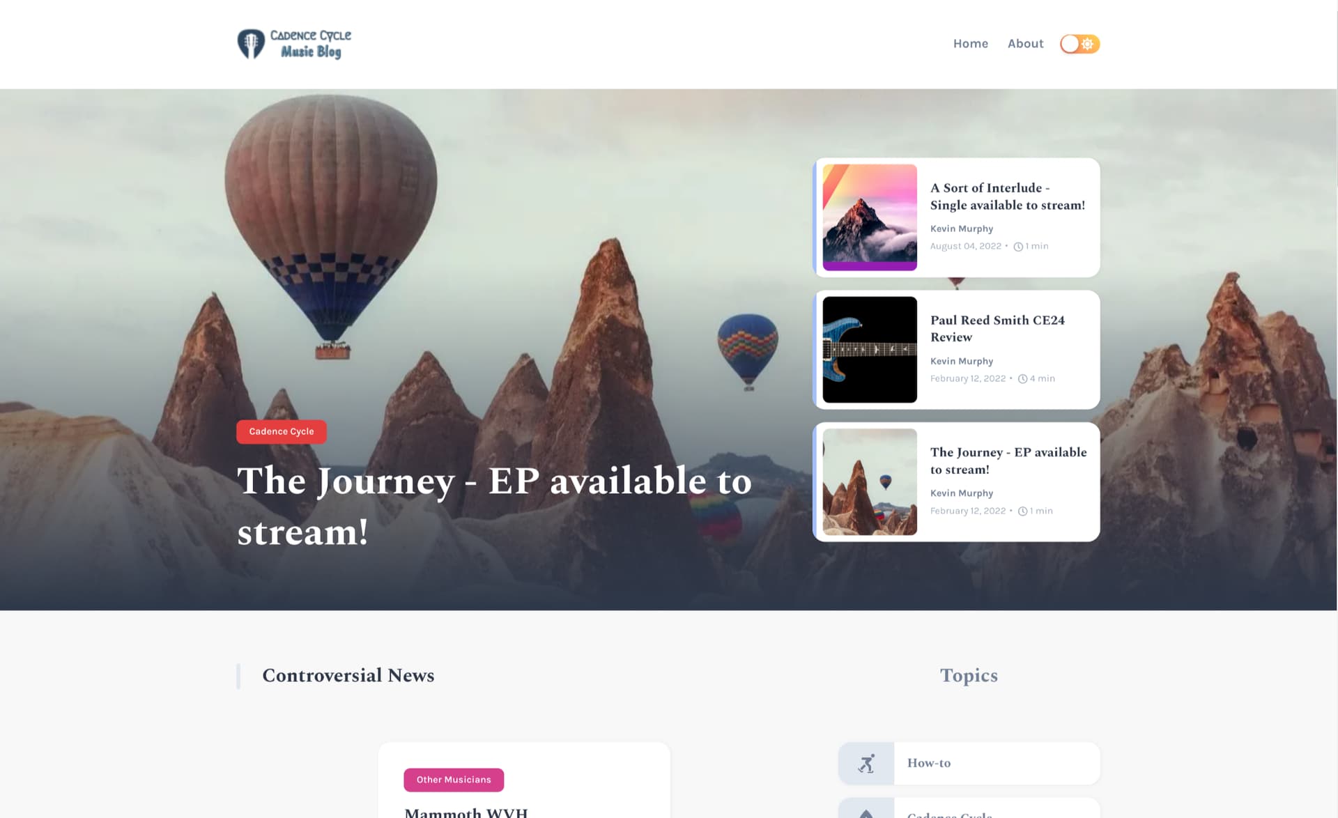

For example, trying to load your site via the non-www link in your post, just in Chrome on my laptop, yielded:
Adding the www to the link yields:

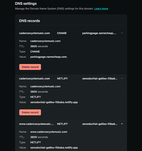

Gotcha, thanks for the clarification. Would a potential solution be going to namecheap and creating a redirect?
The solution will be to ensure requests for the apex are directed to Netlify / www, which you could do with the DNS settings.
Netlify have the following documentation:
I found this dns setting, deleted the extra setting for the non WWW address and it seems to work now. thanks!
