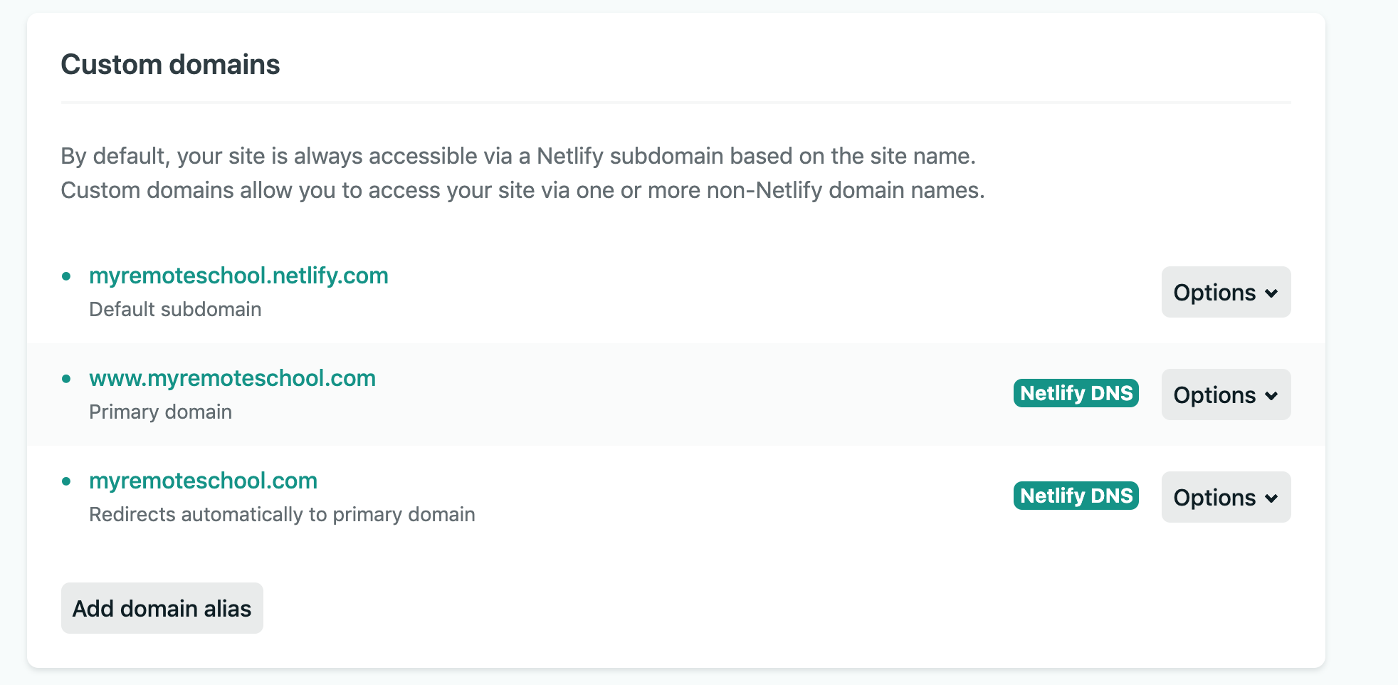

Here is what I have.
Isn’t it ok?
Should I add a DNS record?
Hmm… looks fine to me.
I’m noticing that your TLS certificate is only signed for the www domain despite this config though. I’m wondering if maybe the certificate was issued before you added the apex domain as an alias. If that’s the case, I would try to manually renew the certificate to see if adds the missing domain and fixes the problem.
