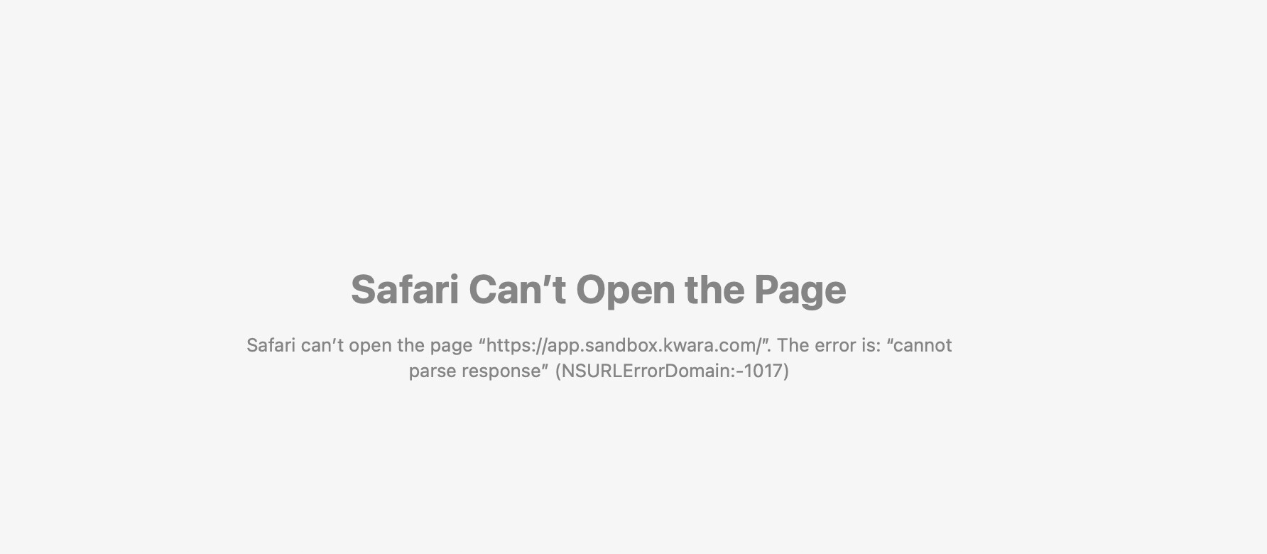

We are facing an odd issue with our sites in Kenya. Whenever us or our users try to access the sites using Chromium on a public wifi or mobile network, the page won’t load at all because of a ERR_HTTP2_SERVER_REFUSED_STREAM error. It happened a few times that a switch to anonymous mode helped, but only for the initial page – the error came back when clicking any further links.
This is happening primarily for sites kwara.com, members.kwara.com and app.kwara.com – but the rest seems to be affected as well.
