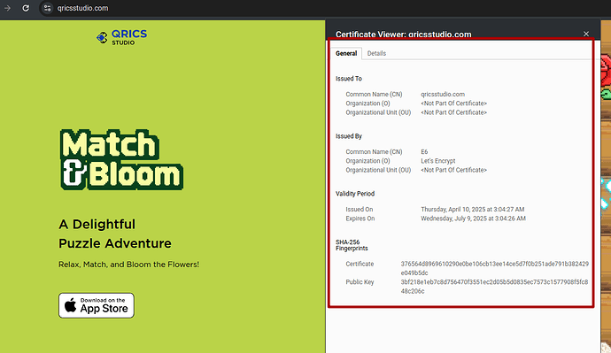

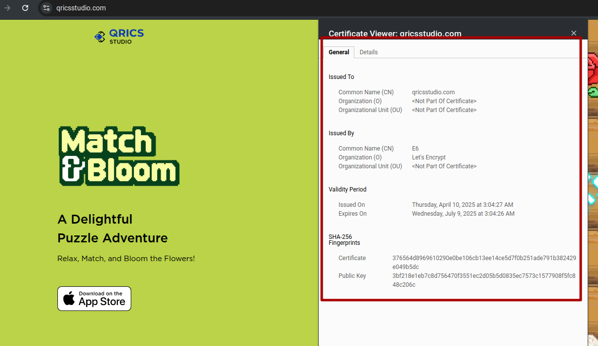

Hi, It seems you have proceeded with using Netlify DNS(Netlify nameservers). As per checking, your DNS records and site, everything appears to be secure. However, I’m a bit concerned about the A record 75.2.60.5(load-balancer) that is currently propagating. This A record is associated with the External DNS method, which is intended for cases where you are not using Netlify nameservers.
Although your site is currently live and secure, keeping this A record may cause a conflict in the future, potentially leading to DNS errors or SSL provisioning issues.
Also, there should not be a CNAME record for www pointing to your apex domain. If you’re using Netlify DNS, Netlify will automatically add the necessary DNS records for your site.
I recommend to remove unnecessary DNS records asap! Hope this helps.
