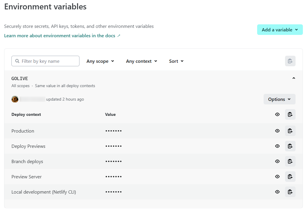

The file code is as such: (and yes I have a GOLIVE environment variable setup as a simple string)

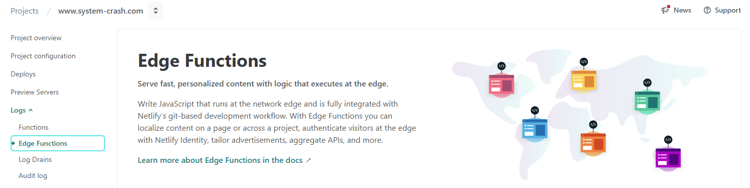

However I don’t see any edge functions in the project UI (maybe I won’t until I deploy to prod)?
Is there anything else I need to do during build to enable edge functions? I don’t think this is a Blazor routing conflict, cause I get a Netlify 404 back, and not a Blazor redirect.
I setup the Netlify CLI and tested this locally, which half worked. The edge function ran, but oddly enough Netlify.env.get("GOLIVE") returned undefined (despite being logged in, and the documentation stating it would pull all the environment variables from my project).

I’m going to have to dig into this a little deeper. There is still the issue of Netlify.env.get("GOLIVE") returning undefined… so if anyone knows why that may be happening, please let me know.
Okay, I made one big mistake… turns out I was using the wrong folder, I should not have been using wwwroot, because Netlify expects to scan the actual base directory for edge functions. So I moved the netlify folder up to the project root and now it’s working as expected when deployed (the environment variable is even returned correctly).
