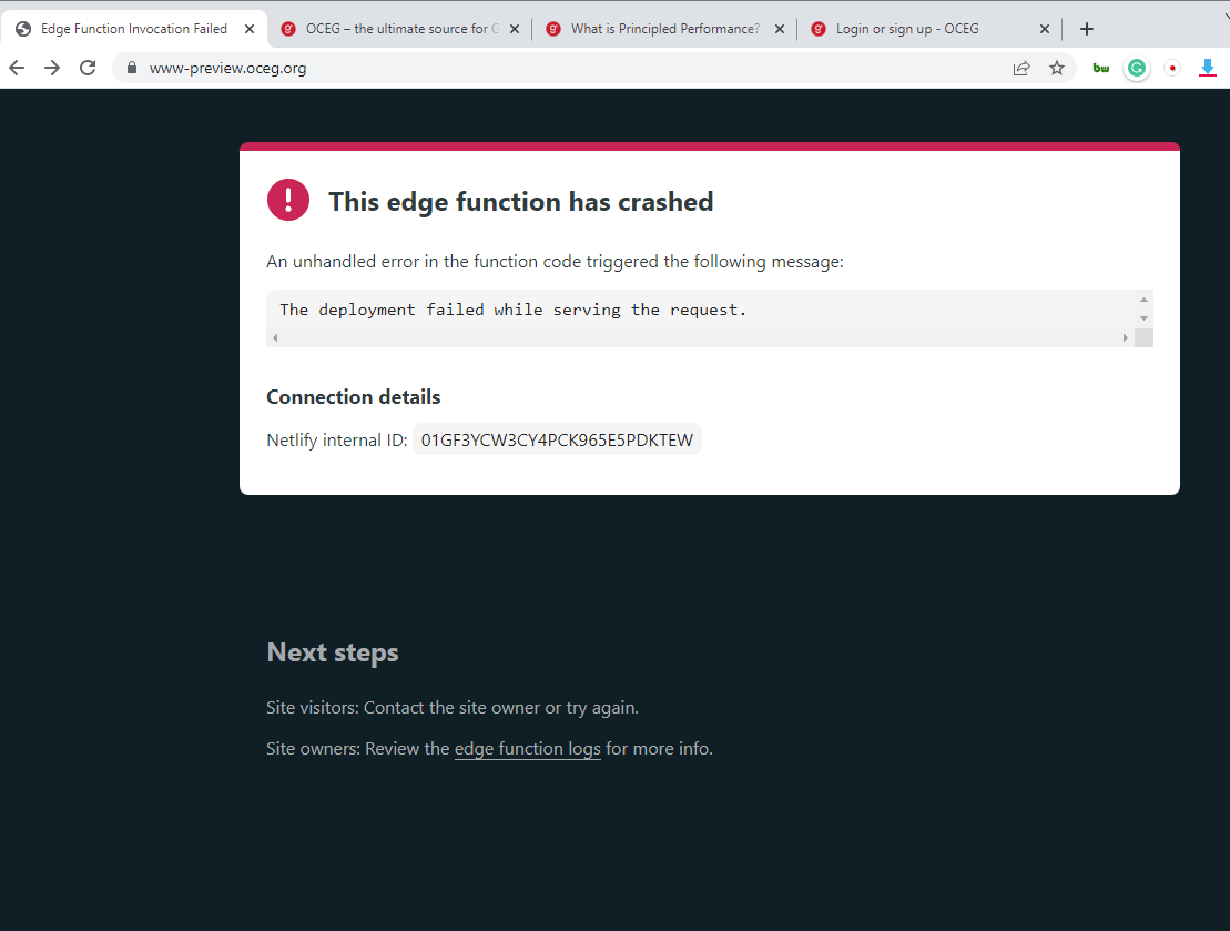

After deploying our site we seem to be consistently getting generic ‘This edge function has crashed’ errors on all pages, they hang for a while and finally return an error page. After a few minutes all pages work fine. Could that be a cold start issue at the edge? We are getting nothing at in the edge function log.

As I’m typing the site is rendering and logging when viewed from Arizona. Where I am in Panama, I get this:
An unhandled error in the function code triggered the following message:
The deployment failed while serving the request.
Connection details
Netlify internal ID: 01GESH129V5772Q5SJA8E8HEAG

Thank you for those. These errors are not unique to your site. The devs have already engaged into discussions with the upstream provider on how to make this better. There is a lot of work going on into improving the logging experience at the moment, so hopefully, next time this happens, you can see the error yourself (or at least we can see some useful error message in our logs) - none of which is happening at the moment.

Hi all,
We have identified a problem residing in an upstream service that is causing these timeouts. Presently we are working with the provider on this issue and are waiting for a code fix from them. We apologize for the inconvenience and are doing as much as we can to aid the provider in the restoration of service.
