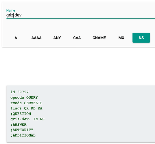

I may be doing this wrong, but I’m seeing something different using the GSuite Toolbox dig command. When I run that on grizfans.dev, I’m seeing NS results that match the Netlify name servers:
But, I get an error when checking the NS records for griz.dev
I see the problem - this was my mistake. I accidentally posted the wrong URL in my first post, I own both. Please disregard the .com version, it is the grizfans.dev domain that I meant to compare. I’m sorry for that mistake.
so, when comparing griz.dev vs grizfans.dev, the latter works, yet both seem to be configured the same in both Hover and Netlify’s DNS
Hi, @grizfan, this issue is happening because DNSSEC is enabled for this domain and Netlify DNS doesn’t support DNSSEC at this time:
