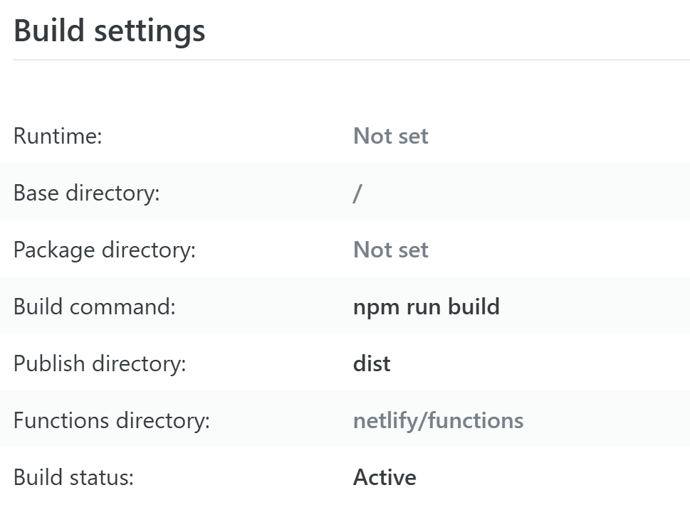

I have been testing creating some simple one page web applications using Replit and I’m not looking to host it in Netify but I’m running into build issues which I believe are related to the folder structure that Replit created.
I either receive 404 error for https://goliathprotocol.netlify.app/ or make some changes to the build settings I can at least get the web app to launch but none of the functionality works.
After two days of changes and countless discussions with ChatGPT I decided to post for some help before I try debugging via VS Code or Cursor.
My index.html exist in a client directory off the root so this is what I add to my netify.toml but it fails. Leaving it empty returns a 404 error when accessing the site.

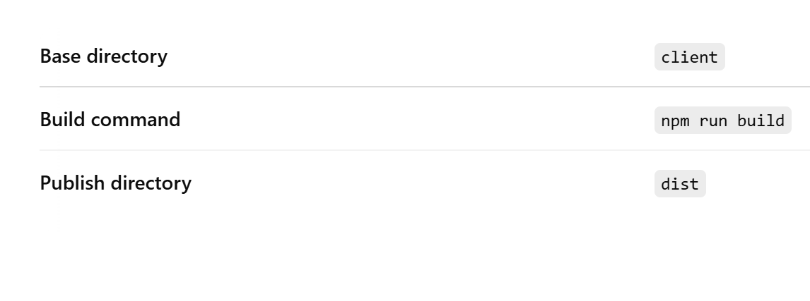

Repo is GitHub - flexfanatic/NetworkProtocolTesterv2 but yes, the index is not located in the root directory. Its located in the client directory so I thought I could reference that in my build settings.
something similar to:
@flexfanatic That won’t work.
It seems to be a misunderstanding of both the project files and what the Base directory is for.
The Base directory is for: selecting what folder Netlify’s CI will start within.
Your client folder contains source files for a portion of your application.
The Base directory is:
  • Base directory: directory where Netlify checks for dependency management files such as package.json or .nvmrc, installs dependencies, and runs your build command. The build system will use this directory to perform caching during the build process. If not set, the base directory defaults to the root of the repository.
So, if you set it to client then Netlify wouldn’t be factoring in any of the files above that directory (which is basically all your configuration files, your package.json etc).
