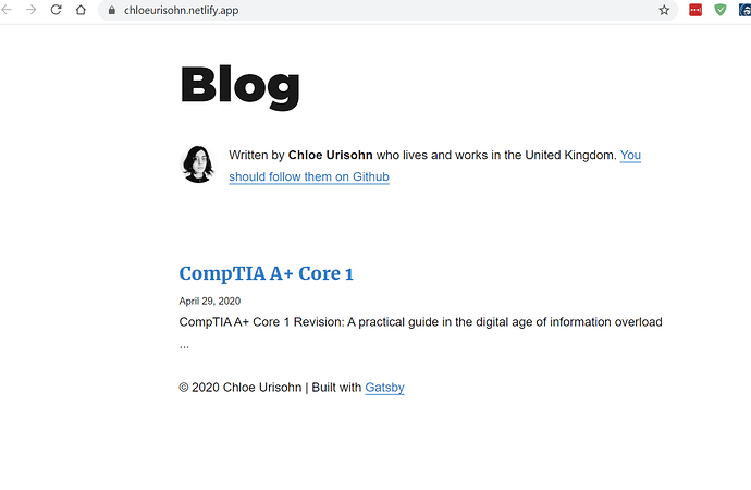

thanks for that! it all looks correct, actually. And when i pulled your site, i can see this:
what are you seeing?
can you link us to one of those failed deploys so we can read through the error log, please?
i’m going to guess the problem is one of your dependencies not playing well with another one, or, it is this problem:
Sounds like you’re up and running (:partying_face:) since removing that plugin from your Gatsby config, but the issue may have been (reading your package.json) that you hadn’t installed the plugin yet: npm install --save node-sass gatsby-plugin-sass
Please give a shout if we can help with anything else!
