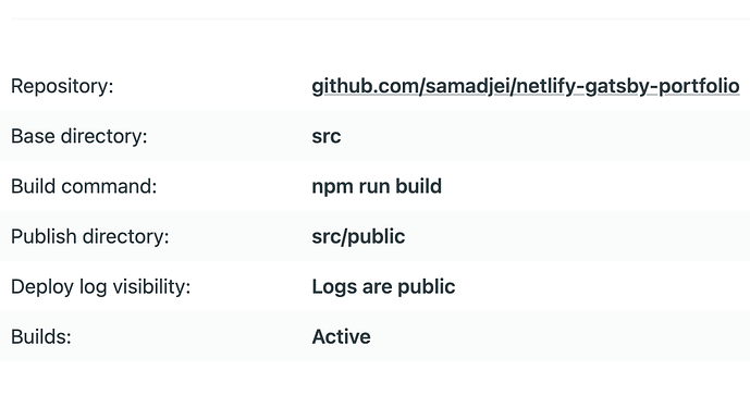

My build settings

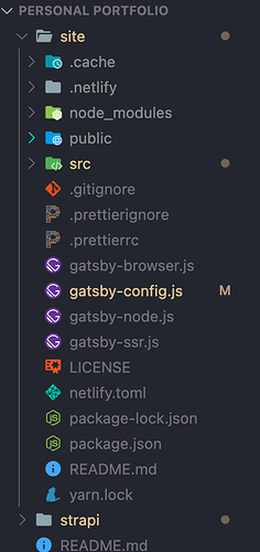

Here is my folder structure
Here is my build settings:
hi there, do you have a directory called public in your repo? if not, add one.
Hi apologies, i just edited the message with the correct screenshot. And yes i do.
i think we can’t find public because it is inside of site. :thinking:
can you move it up a level and see if that fixes things?
TBH i’m not sure how to do that :no_mouth:. I tried removing public form the gitignore file and deploying but I got the same issue.
Change publish path to site/public

hi there, please try the following settings:
repo: keep as is
base directory: leave it blank
build command: leave as is
publish directory: site/public
deploy log: leave as is
builds: active
